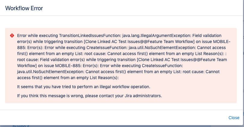

I seem to be much closer thanks to your help.  I'm sure I have made an error so hoping you can walkthrough what I have set up and another set of eyes can find.  Here's the error I am receiving:

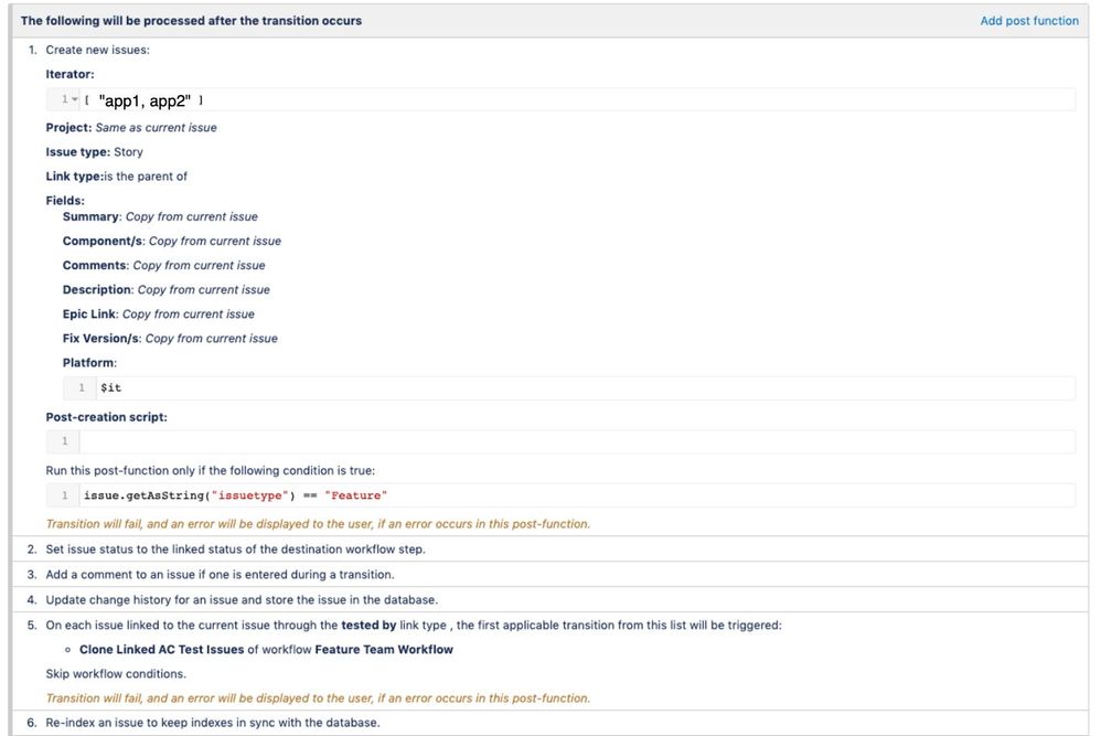

Here's the Clone Feature "Ready for Development" transition set up:

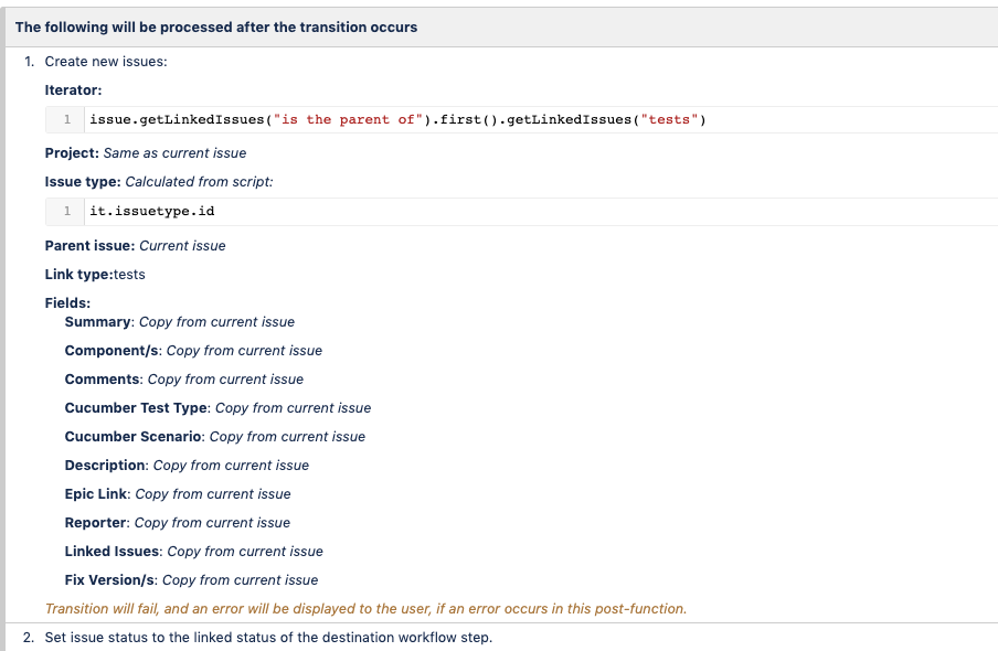

And here's the Cloned Linked AC Test Issues transition set up:
I'm sure I'm doing something wrong here in terms of the iterator statement you provided....I've changed the linked issue type(s) in the statement multiple times using different values and still getting the same error.  Thanks again so much for your help.

I think the Stories itself are not created. Because the iterator script is wrong. It is currently:
["app1,app2"]
Which will try creating one Story with the Summary "app1, app2". But since you are trying to set the Platform field to "app1, app2" which likely is a select field, the option turns to be invalid and hence the issue cannot be created. Please fix the script to:
["app1,"app2"]
save the post-function, publish the workflow and retest.

Hi @Radhika Vijji _Innovalog_  the stories are created...that's an edit I did to the screenshot to not show what could be propietary info. That part of the script works fine.

  1. The Create issue post-function on the "Cloned Linked AC Test Issues" does not see the link issues because the link type specified is incorrect. It needs to be:
  2. issue.getLinkedIssues("is the parent of").first().getLinkedIssues("tested by")
  3. In the Transition related issue post-function the specified link type should be the link from the Feature to the created Stories, which is the other direction of "is the parent of".
Can you fix these and retry?
