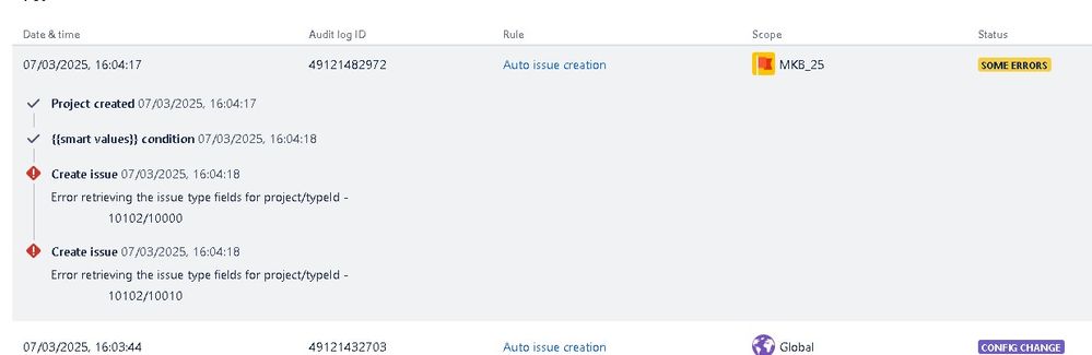

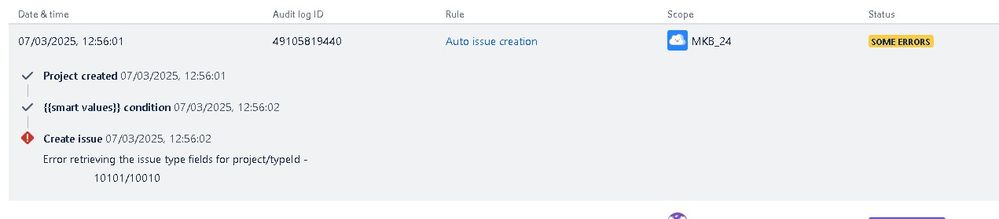

I am having troubles (and tried 1000 ways how to fix) running automation (global) that is triggered upon Project creation. Trigger works perfectly, but i can not create a single issue/task. Everything is blank, out of the box, no custom fields, values etc but i am still getting this error
Error retrieving the issue type fields for project/typeId -
10101/10010
I tried different issue types (they are properly mapped in project), custom fields, ALL fields possible, no difference, every time this error. Cloning the issue works, but not creating from scratch. Also tried making actor as myself (admin) rather than jira automation.

Hi @Samuel Imrich -- Welcome to the Atlassian Community!
The likely cause of that symptom is timing (i.e., a racetrack condition) where the Project Created trigger fires before the project configuration (including the issue types) is fully available...leading to the errors you observe.
For workarounds, something needs to happen to slow down the rule a bit after the trigger and before the Create Issue actions.  What license level of Jira are you using?
  • If you are on the Premium or Enterprise level, the Delay action could be used to pause the rule for a while until the configuration completes: https://support.atlassian.com/cloud-automation/docs/jira-automation-actions/#Delay
  • If you are on the Free or Standard level, that action is not present.  Instead you could try performing some actions which take time to slow the rule.  This still may not help as the duration needed is unknown, but it is worth a try.

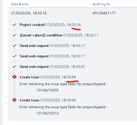

Samuel Imrich
March 7, 2025
Hey Bill, Thanks for your answer!
I tried delaying the execution by adding three dummy web actions just to prove the concept (and wait till response is received). There was more than 30 secs of delay between project creation and Create issue state but it failed as well. Or should it wait longer?Screenshot 2025-03-07 183428.jpg
Bill Sheboy
March 7, 2025
Just to confirm, what type of project is this for: company-managed or team-managed?
If this is for a team-managed project, their issue types are unique for each project.  That is, the internal ID for the issue type is different even when the names are the same.
The saved ID values in the Create Issue actions will not work as they are unknown when the rule publishes and they cannot be updated dynamically.  (At least that was not possible when I tried this scenario a year ago.)
I believe the only workaround is to use the Send Web Request action to call the REST API and...
This approach will likely eliminate the need for other delaying rule actions for the racetrack condition.
Samuel Imrich
March 7, 2025
Uff, thats a really complicated workaround for such a simple task, but you are correct. When i tried changing the project type to Company managed, automation ran without any issues, so thanks for that! At least now I know where to look.

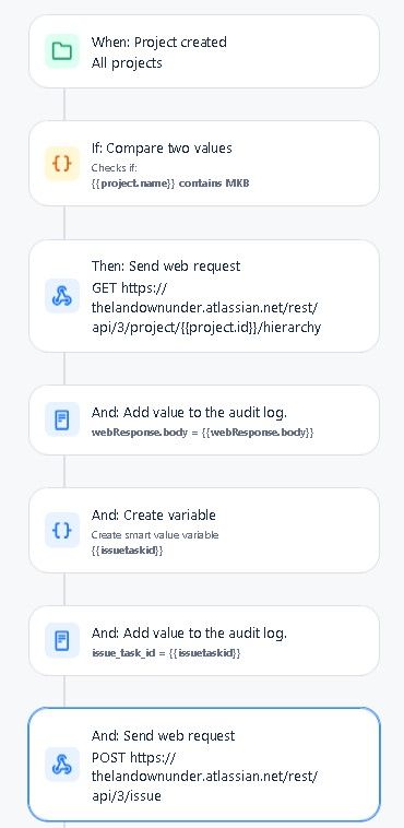

Samuel Imrich
March 10, 2025
@Bill Sheboyjust FYI, i managed to get it working with proposed solution using API, although i must admit that this solution is so overkill for the thing that it really does - just creating a task on newly opened project.

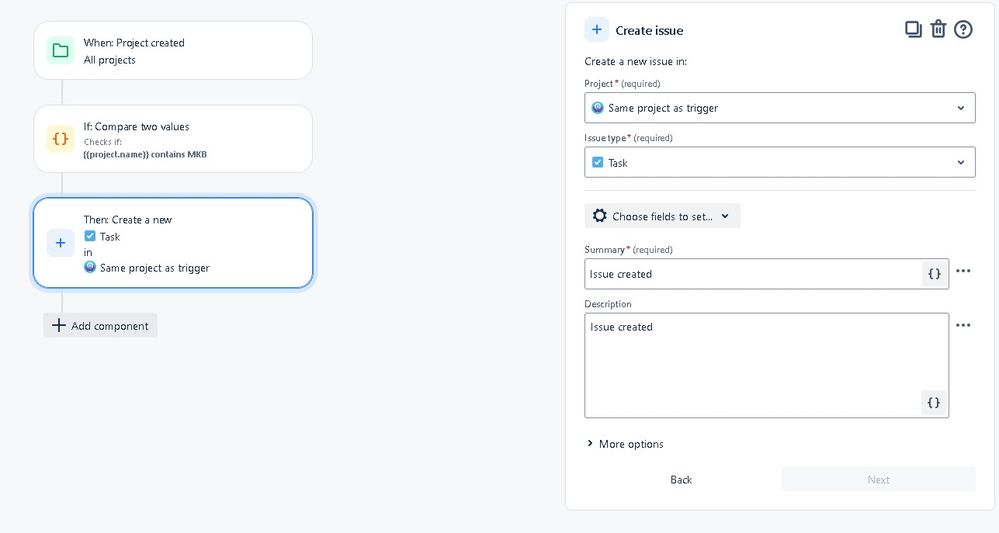

Samuel Imrich
March 7, 2025

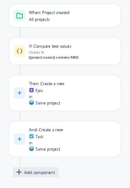

Thanks Jeremiah, but the trigger itself is not a problem, the problem is simple and basic operation which is "just create a task". I have done complicated things in prod, this is just testing in my dev but cant get a simple task being created for no valid reason.Screenshot 2025-03-07 152804.jpg
Vishal Biyani
March 7, 2025

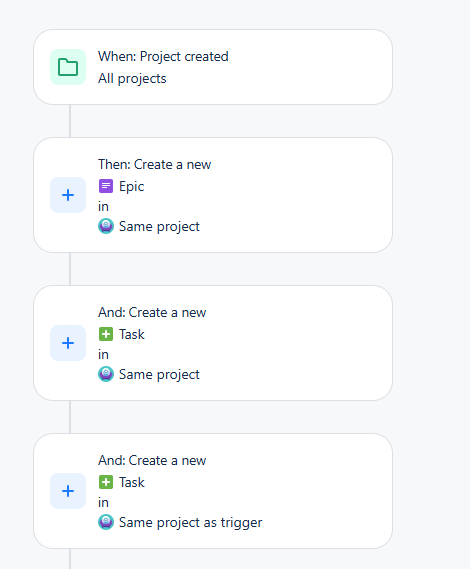

Samuel Imrich
March 7, 2025
Vishal Biyani
March 7, 2025
@Samuel Imrich
Can you try using same project instead of same project as trigger?
Also, not sure if creating a Epic first makes a difference.
In my cloud instance the rule is executing file and creating the issues
Samuel Imrich
March 7, 2025
Did exactly the same thing, error as usual (but the first ID is the one from Epic)Screenshot 2025-03-07 160827.jpg
