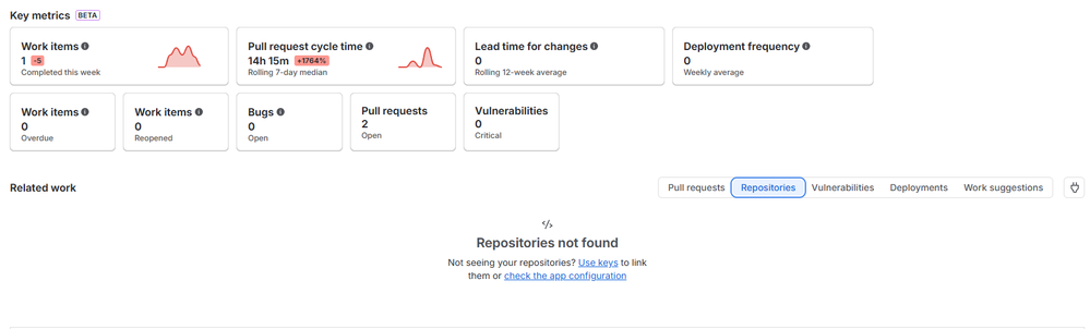

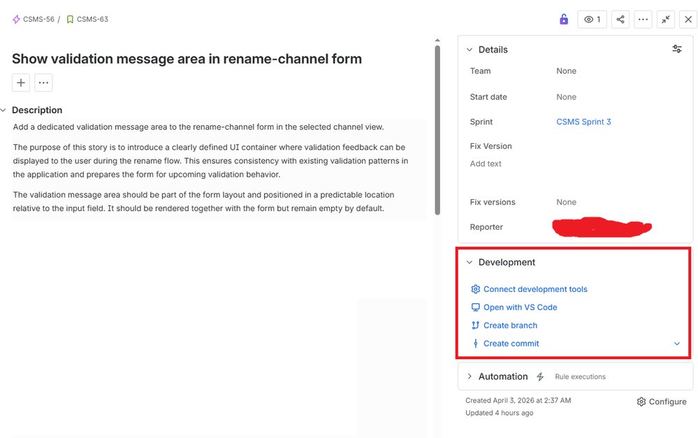

  • Branches and pull requests stopped appearing inside Jira issues
  • In the Development section, repository activity stopped updating correctly
  • I pushed an empty commit to test it, and Jira detected the commit only, but still did not detect the related branch or pull request
  • The Create pull request button disappeared from the Development section after the first backfill attempt
  • Backfill does not restore the missing development data
  • After the reinstallation of GitHub for Atlassian and Atlassian on GitHub, even development data that had previously been synced correctly on older Jira issues became unsynced, and backfill has not restored it. This is a major problem for our team because it affects not only new activity, but also tickets that were already linked correctly before

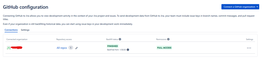

The repository is still connected in GitHub configuration in Jira settings:
  • it shows under the GitHub configuration screen
  • it has Full access
  • backfill status shows Finished

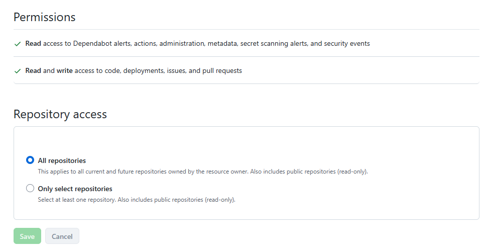

  • re-granted all permissions available

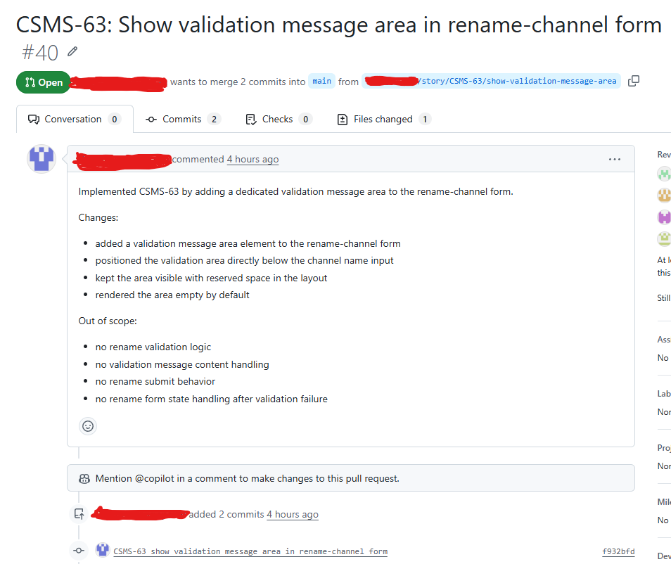

  • and an example PR/branch that contains the correct Jira key but is not being linked.
These screenshots were taken after reinstalling GitHub for Atlassian on Jira and Atlassian on GitHub, and after multiple attempts to continue backfill.
Screenshot 2026-04-12 181036.pngScreenshot 2026-04-12 181122.pngScreenshot 2026-04-12 181150.pngScreenshot 2026-04-12 181356.pngScreenshot 2026-04-12 181450.png
Note: even if the colon is removed from the PR title, as shown in the screenshot, Jira still does not detect the pull request.

At this point, the integration also seems to be functioning correctly for older tickets, with development information such as branches, commits, and merged pull requests displaying as expected.
Initially, the Development status icon on the Board was not updating correctly for some issues. However, after manually opening the affected tickets and refreshing Jira, the linked branches, pull requests, and commits became visible there as well.
