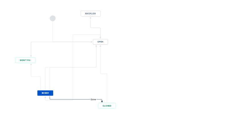

However, we cant seem to get the transition working. Attached is a screenshot of my workflow. I have tried the following commands for a issue that was 'In Dev' -
1. JR-1235 #done
2. JR-1235 #Done
3. JR-1235 #closed
4. JR-1235 #CLOSED
None of them transitioned the issue to closed status.
I have cross checked that the email of user in git repo and jira matches exactly. Appreciate if there is anybody who can help me what i am missing here.

But also for your particular use case here, options number 1 or 2 should work just fine here.  We need to use the transition name, not necessarily the status name you want to go to.  Many times these overlap or are the same (in the case of next-gen Jira projects there are no transition names yet, you actually do have to use the status name).   There are more details and notes on this feature in Process issues with smart commits: Workflow transitions.  It notes:
The committer's email address must match the email address of a single Jira Software user with the appropriate project permissions to transition issues.
It sounds like you already confirmed that part, but it might be worth checking to see if that exact same user has the ability to run that done transition to close that issue.

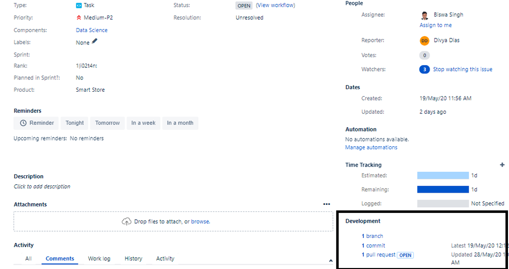

Please note that i am able to get all other integration related capabilities like linking commits, creating PR from within Jira working. Here is a snapshot of a JIRA issue post the integration. I am only having trouble with the transitions. Do let me know if you have thoughts on what else i could be missing.
