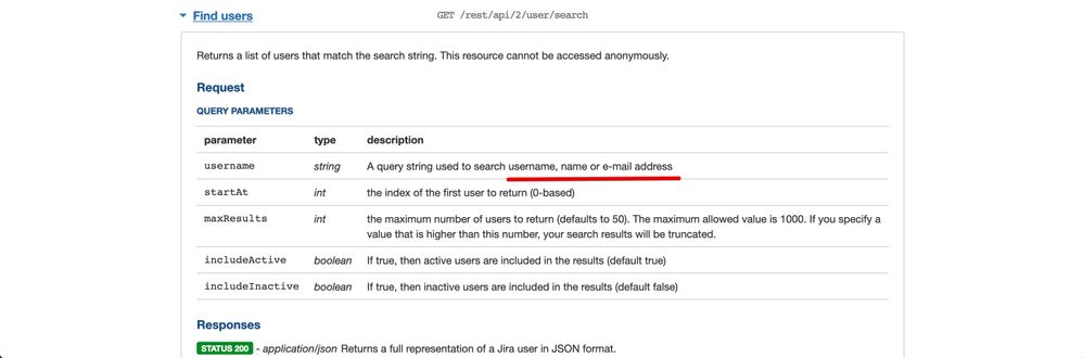

Um, ok. So basically string passed tries to match the username or email or name and returns the result? Yeah that'd make sense, I read it wrong maybe because I was looking for an easy answer :D
@Nir Haimov @Bill Sheboy  Is there a possible way to search users by email, maybe by query?
