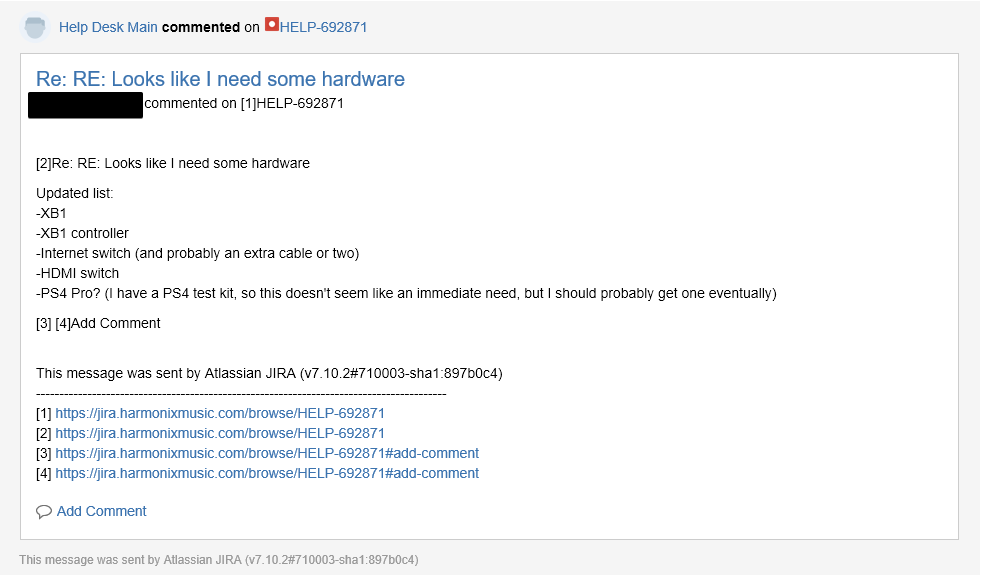

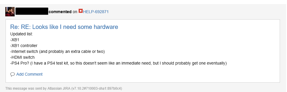

I was trying to troubleshoot the bug that lets restricted users see hidden projects if "reporter" is in Browse, but that's a whole other story. I removed Reporter and Current Assignee from Browse Projects, and it fixed the issue mentioned above. However, now whenever I comment on a ticket in this project, I get a "normal" notification email, and then I get the same email from our shared mailbox (on 0365) account. I added Reporter and Current Assignee back into browse projects, but that did nothing.
I've tried creating a new notification scheme, same result.
I've attached examples of the notifications below.
And yes, I didn't screen cap the settings before I changed them and realize I'm extremely irresponsible. :p
