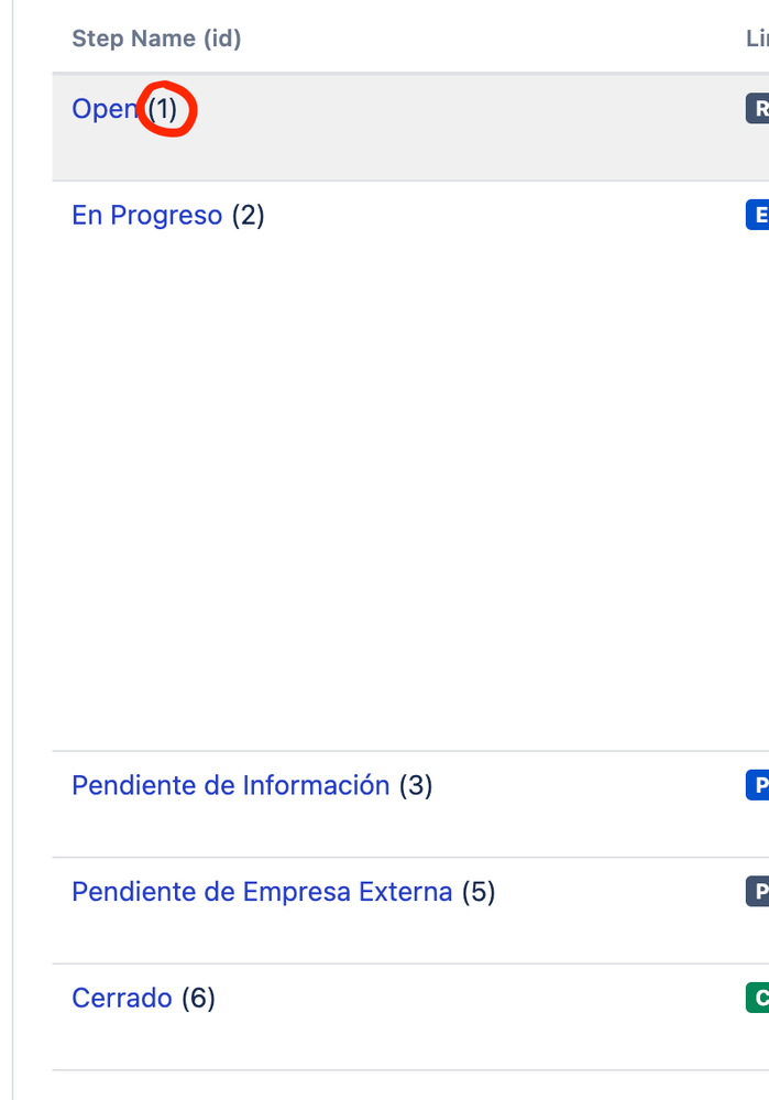

Don't know what is meant by Step 33, any idea?
Daniel Delgado Ramos
May 12, 2021
It refers to the the Step id of the Workflow:
Like Sukamal Chakravarty likes this
