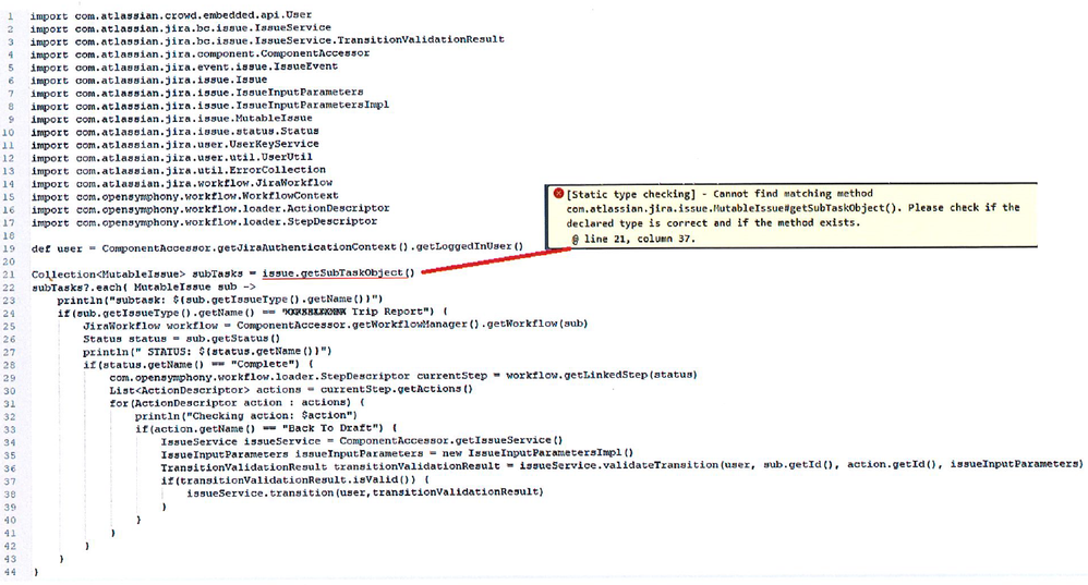

I need help with a script, please.  I have to provide a screen cap, because it is on a network that is not connected to the Internet.
The goal of this script is to transition the Status of an Issue's subtask back to a previous status ("Back to Draft")  when the Issue is transitioned backward in its workflow.  I have the script as a Post function in the Issue's workflow--so it executes when the Issue's workflow transitions backward.  I am getting an error "Cannot find matching method..." see the attached screenshot.  Please help!

that method return a Collection of Issue and not of MutableIssue (https://docs.atlassian.com/software/jira/docs/api/8.5.1/index.html?com/atlassian/jira/issue/Issue.html).
Your code should be :
Collection<Issue> subTasks = issue.getSubTaskObjects();
This should fix your issue.

I made your change, thank you.  On Line 21, I am getting error, "The variable [issue] is undeclared."  Also on Line 22 it says, "Expected parameter of type com.atlassian.issue.Issue but got com.atlassian.jira.issue.MutableIssue.  So something is screwed up on Line 22.  I'm obviously very inexperienced--I inherited this script from someone.  Thank you for your help.

@kdickason , change MutableIssue with Issue on line 22

Okay, that fixed line 22.  I also removed the -> at the end of line 22 (that didn't look right).  Line 21 is still complaining about the variable [issue] is undeclared with a red x in the script editor.  Anything I can do for that?  Thank you again and again...

Are u using Script Console?
Fabio Racobaldo [Catworkx]
February 15, 2022
If you use a Custom script post-function "issue" should automatically associated to issue in which you perform the transition ;)

I have it within the workflow as a post function at the moment.
