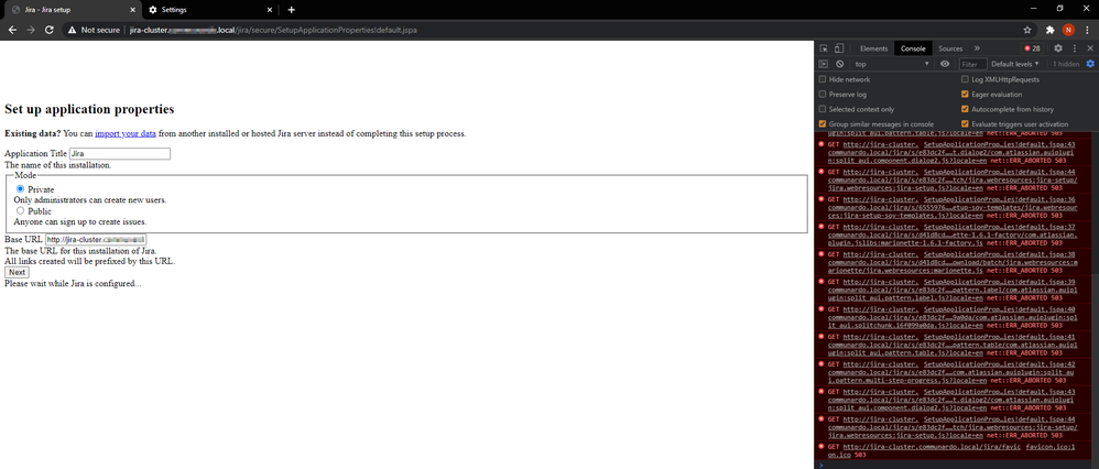

But now the issue: We can reach all of the three JIRA nodes via the Apache2 and we get the Cookie for the Session. However, we get a lot of 503 Errors when accesing each of the JIRA dashboards or the setup wizard.
image.pngsdsdsd

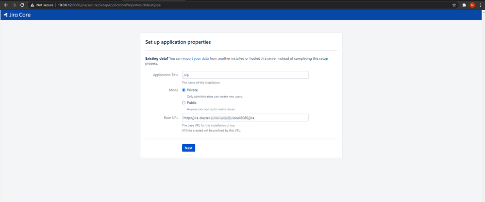

However, when I access the JIRA node directly via the Tomcat we get a perfectly fine webpage
The same happens when I remove the balancer part of my vhost apache2 config and replace it with a direct path to only one of the JIRA nodes. Therefore we believe the apache2 and especially the balancer configuration shredds the site.

To finish this up. Looks like the missing ProxyPort was the Issue. It was creating "Cross Site Request Forgery" Errors in the logs and after I added it, the website was shown as expected.

What did help though was fixing the connector attributes in the server.xml as in https://confluence.atlassian.com/kb/cross-site-request-forgery-csrf-protection-changes-in-atlassian-rest-779294918.html. Especially adding the proxyPort. I also changed all permissions in the JIRA home directory to 755 (was 750 before) so that could have also played a role in my solution but I will verify when I spin up the environment again (working with vagrant VMs).
