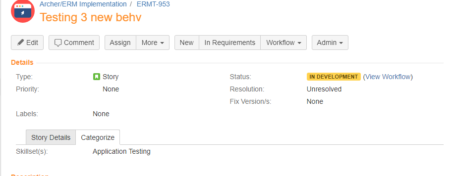

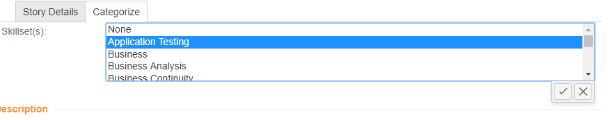

ssf.PNGThe Skillset(s) field is under a tab called Categorize.
Judah
August 20, 2019
Working now! Thank you!
Are tabs, such as the ones pictured above, considered part of the transition screen only if they are selected? ie. "story details" and "categorize"
Ilya Turov
August 20, 2019
no, transition screen is well, what it is, a transition screen, and it has nothing to do with view/edit/etc issue screens. and it can have it's own tabs
