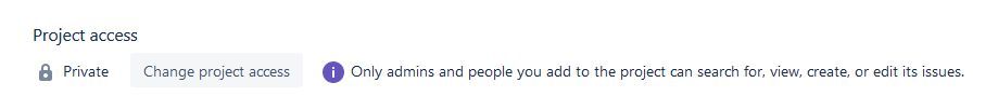

Hello @[deleted] ,
I am afraid this is not what I am getting, and that's why I wrote this post in the first place.
The isPrivate field is returning False for a next-gen project I created and I am managing. I am positive it has private access,
I should be getting True instead, if documentation is correct as you say. Or might we be meaning different things for "private permissions" ?
