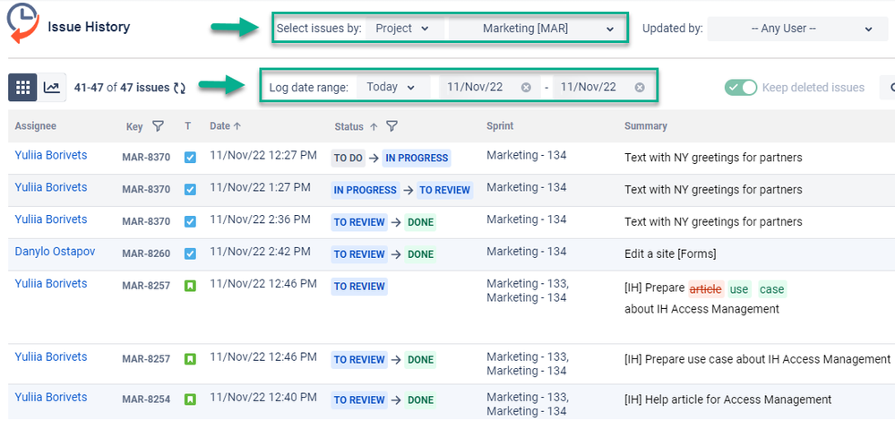

I can suggest an alternative solution to get updates for the custom field for a specific time frame. If you are ok with add-ons, check out Issue History for Jira. My team developed it to get change reports for any list of issues. You can monitor changes for standard or custom fields.
Export to CSV/Excel is available.
You can check how it works for you with 30-day free trial.

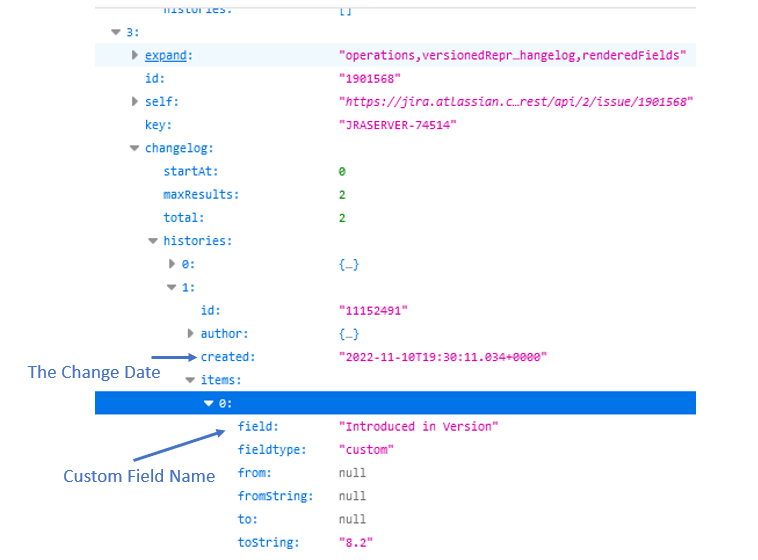

To get JIRA Issues based on custom field changes, you could try the below approach
  1.  Query the issue history (change log) along with your JIRA Issues
    REST API Call example
    https://jira.atlassian.com/rest/api/2/search?jql=project=%22JRA%22&expand=changelog
  2. Filter the JSON results based on custom field change Date.
  3. If you are willing to automate this solution, you could use PowerAutomate to make the REST API Call and filter the JSON data based on custom field change date with almost no code. Alternatively, you can handle it with script runner (groovy) or any other scripting language with some/little coding effort.
