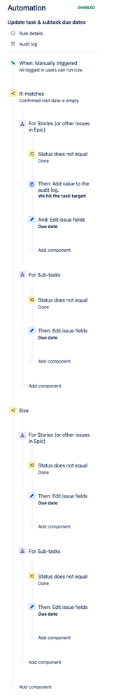

Note that some of the complexity you see in the automation below is due to the fact that I have two different date fields that will be used to calculate task due dates depending on whether the visit date is 'penciled in' or confirmed. Once confirmed, the automation can be run again to adjust the dates to the new date that may be introduced.
Rick Crow
October 20, 2021
By the way, I should have mentioned that the other problem I'm having is in simply targeting the sub-task from the triggering epic issue ... which may ultimately be my biggest problem as the rule as you see it here fails to target the sub-tasks.
What is the appropriate way to target a sub-task in this scenario?

b) Sub-task handling for rules trigger from the epic
The reason your rule doesn't update sub-tasks is the trigger issue is an epic, and one of your branches is trying to reach sub-tasks of the included stories/tasks: that cannot work as automation rules cannot nest branches.
One work-around for this is to build rules to operate on parent/child pairs, and then let one rule trigger another.  For example:
  1. Rule with epic issue triggered and can update its child story/task/bug issues
  2. Rule with story/task/bug issue triggered and can update their sub-tasks.
To make this work, Rule 1 makes a change which can lead to triggering Rule 2, and in the details of Rule 2, enable the option "Allow Rule Trigger".
There is a more complex work-around to do epic-to-sub-task synch in one rule, and it involves building a dynamic JQL statement from the sub-task lists of the story/task/bug issues.  I tend to avoid that one as it is slow, difficult to debug, and could exceed the 100 issue limit for rule processing.
