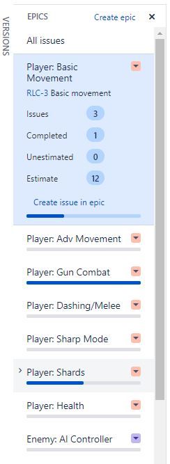

I would like to display in a big list, all components, each row would have the component name, number of issues completed, total number of issues, and a progress bar that displays complete vs incomplete.
This is similar to how Epics are displayed in the backlog, where you have a list of them that each have a progress bar representing complete vs incomplete issues.

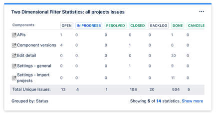

I have been able to get a dashboard two axis table working, but the components are out of order and the status' are also not in order, which makes it a pain to understand at a glance.

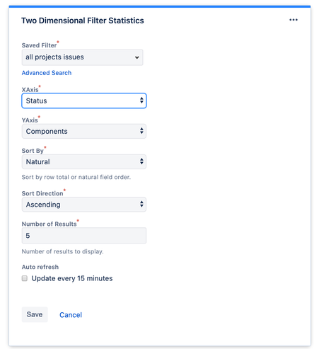

the closest I can think of is to use Two-dimensional filter statistics gadget on Dashboards.
If you don't have that many statuses in your projects this might be good enough. But if you have too many it might become a bit messy and I would probably try to research some visualizations plugins.

I'm afraid there's no sort order in the gadget - it just works off the ID in the database, which means most of the labels are in a simple "created first to created last" order.
