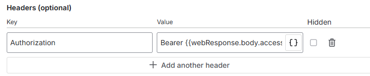

Are you sure about the "webhookResponse" smart value? I know it exists for Jira Data Center but on Jira Cloud I always use "webResponse".
Here is what I have for the Authorization header.
Bearer {{webResponse.body.access_token}}
+ make sure you check this option on the call where you are requesting the token "Delay execution of subsequent rule actions until we've received a response for this web request"

Charlie Misonne
November 5, 2025
And is what you are getting in the variable the expected value?
I'm doing the same, also to trigger a PowerAutomate flow and I did not have to deal with any newlines in the response.
I'm not storing the token in a variable first. I use the smart value directly as Authorization header. Perhaps this can cause a difference.

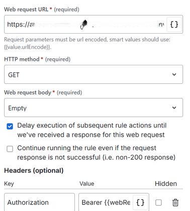

Steven Vits
November 5, 2025
This is what the rule looks like:
getting the acces key
storing the key in a variable and audit log for troubleshooting:
And the get action, I also tried with post (also changed in power automate off course)
And the audit log itself:
Charlie Misonne
November 6, 2025
Hi Steven,
Have you tried using the token logged by the automation rule in postman? Does it work?
My setup is the same except for the initial call to get the token.
In the payload (custom data) I did not URL encode the data. I'm just using this:
grant_type=client_credentials&scope=https://service.flow.microsoft.com//.default
I also noticed your "scope" is different". Not sure why the reason for that is.
An improvement but certainly not related to your issue:
Again in the custom data: I do not provide client_secret and client_id because you can not encrypt/ mask that part in the automation rule.
The endpoint also supports the Authorization header with the value <client_id>:<client_secret> encoded with base 64.
So:
