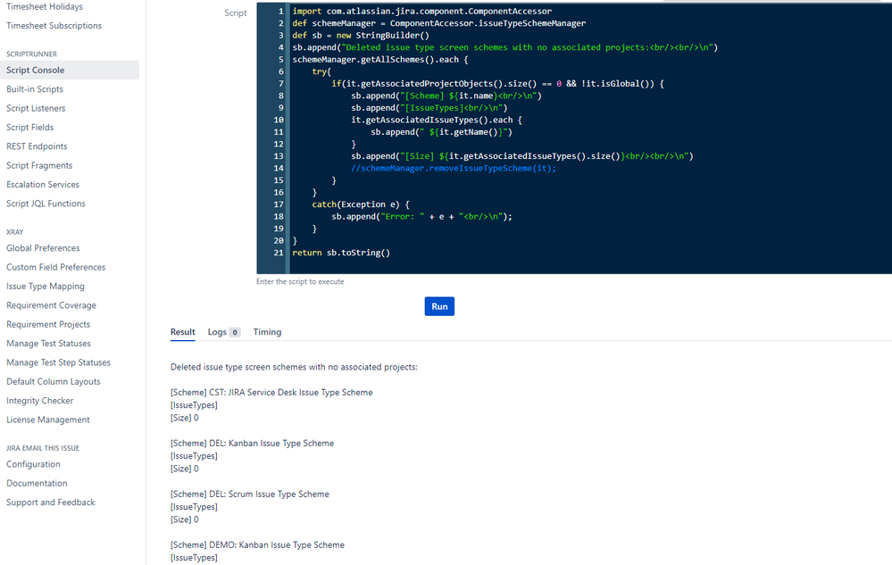

Can you please share the screenshot of the exact code and the console output. Because it's hard to beleive that the issueType scheme contains the issueTypes yet it's displayed as 0 in the logs.
schemeManager.getAllSchemes().each {
print it.getName() // here you can check if you see the name of all the issueTypeschemes and then see the issueTypes contained in them
Steffen Becker
December 20, 2018
Tarun Sapra
December 20, 2018
Hello @Steffen Becker
Thanks for sharing the screenshot, just a hunch, I feel that the method
"getAssociatedIssueTypes" is returning 0 because "getAssociatedProjectObjects" is returning 0 , i.e. the method "getAssociatedIssueTypes" returns only the issueTypes which are actually part of an scheme which is associated with an project.
Can you remove the criteria "getAssociatedProjectObjects.size() ==0" and see if there is output for the method "getAssociatedIssueTypes" because if there is an output in this case then it will be bug in the API as there seems to be no way to get issueTypes of schemes which are not having any associated projects.
