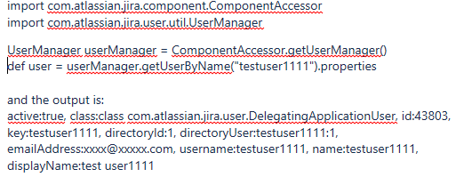

But actually, I have jira 8.4 and for newly created users, still name =key
so I created user and run:
Maybe I check something in wrong way???

I'm not sure if your method is wrong exactly.  But perhaps it is pulling back unexpected user account records.  I could see a scenario where your query could be pulling back a username from an unexpected user directory. If you have multiple user directories in Jira and they contain the same username, it's possible your method could be pulling back data of accounts that exist in different user directories.
I tend to query the SQL database directly in cases like this. I am not used to checking in the manner you described there, but I take it you are using scriptrunner (or an alike) to query the Java API for this info.  I installed scritprunner, and copied your script there in my Jira 8.4.1 site.  I got back the expected user key there.

So You are right, in DB value is, in my case Username: u47592 and User_Key: JIRAUSER43863.
But in such case, what this method is doing? because I expect that if I run it like that:
import com.atlassian.jira.component.ComponentAccessor
import com.atlassian.jira.user.util.UserManager
UserManager userManager=ComponentAccessor.getUserManager()
def user = userManager.getUserByName("u47592").getKey()
It should return JIRAUSER43863 but what I actually receive is u47592.
Is this a bug in getKey() method?

The method you refer to is designed to let you input a username, and get back the user_key value.  I believe that is what it is doing here.  I'm not confident this is a bug though yet. I mean it could be, but I can't recreate the problem you have described so far and I do not feel that I know enough about your environment to understand the results you see here so far.  From that description of that method:
Returns the key which distinguishes the ApplicationUser as unique. The same key is shared by all Users with the same username (ignoring case) across all user directories.
