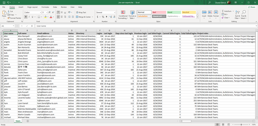

You can do this with our Better Excel Exporter app by exporting the users, see the last column:
See: https://midori-global.com/products/better-excel-exporter-for-jira/data-center/documentation/user-export
(Discl.: it is a paid and supported app developed by our team.)
EDIT: I just realized the question is about Jira Cloud. Although the app is available for Jira Cloud, the user export template is not... Jira Cloud has a built-in user export feature, but that unfortunately doesn't export project roles.
