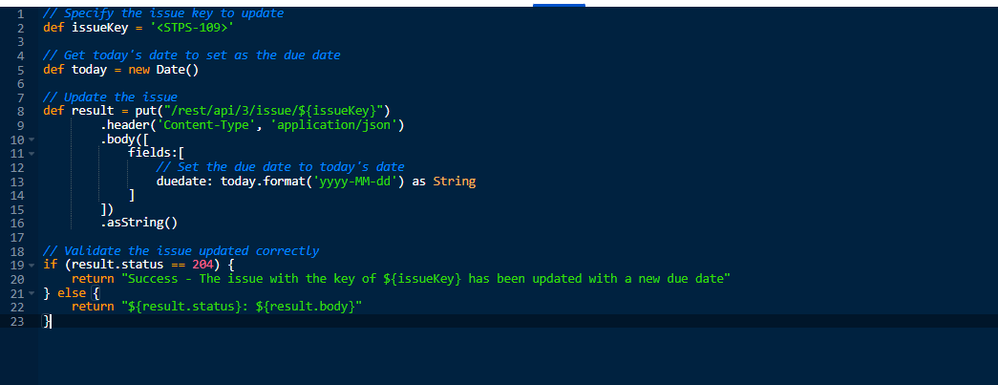

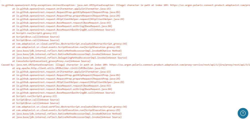

I'm just browsing in Built scripts of Adaptavist script runner plugin .
i'm trying to update Due date of issue through the script ,please find script in attachment.
but I'm getting this illegal character in path error .can someone please help ?
Ram Kumar Aravindakshan _Adaptavist_
July 18, 2023
Hi @CHINNAMUTHEVISAI.SATYANARAYANASHARMA
From the code screenshot you provided, you have declared your issue key as:
def issueKey = "<STPS-109>"
This is incorrect.
Please remove the lesser than and greater than symbols, i.e. < and > from the issue key and declare it as:-
def issueKey = 'STPS-109'
and see if the error persists.
Thank you and Kind regards,
Ram
July 18, 2023
Hi Ram,
Thanks it worked . actually I'm learning script runner Just now .

Nic Brough -Adaptavist-
July 18, 2023
You have not given us the part of the error message that is telling us what the problem is.
If you want an answer to this, we're going to need to see the whole error message.
(i.e. don't do screenshots, give us the plain text of the whole of the error)
July 18, 2023
Issue is resolved . i removed < and > sysmbols from issue key and its worked.
