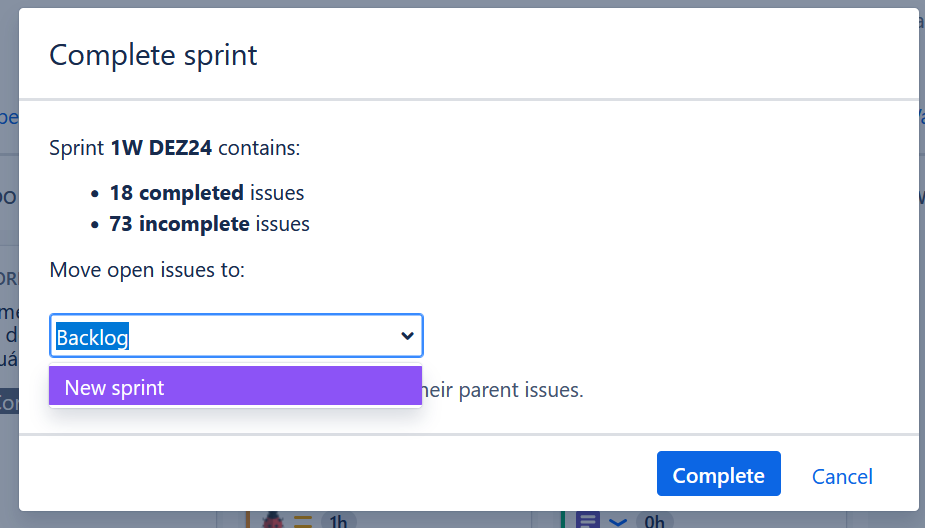

Natively, the sprint change happened as shown in the print below.
Is this behavior different for you? Would there be evidence of how the user performed the action?

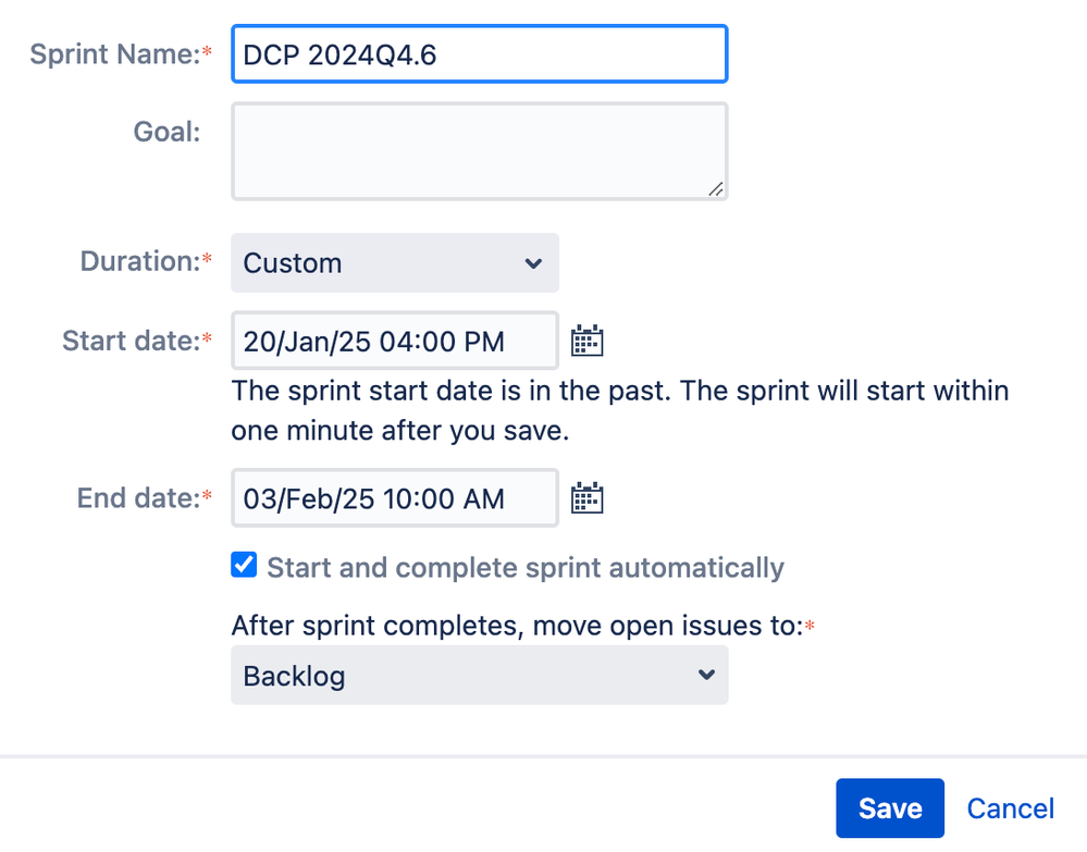

Hi, I'm the user. @Layssa Souza . Rather than manually completing the sprint like in your screenshot, I checked the box for "Start and complete sprint automatically" as in the screenshot below. For the sprint that completed automatically, it worked correctly, moving open issues to the backlog. However, it ALSO moved some issues out of future sprints (that had not started or completed yet) into the backlog as well, which was not expected.  Screenshot 2025-01-21 at 12.39.33 PM.png

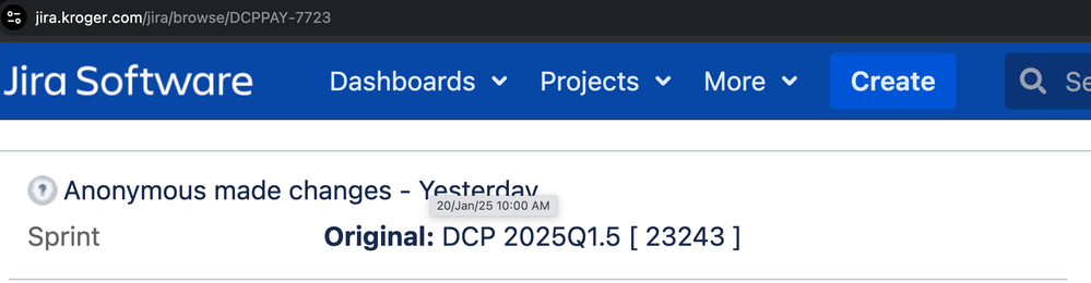

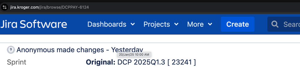

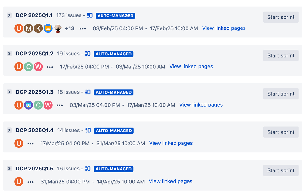

@Layssa Souza Sprint DCP 2024Q4.5 completed on January 20th at 10am and open items from that sprint moved to the backlog as expected. However, nothing displays in the History where it worked correctly, as they are still part of the DCP 2024Q4.5 completed sprint. Below are examples in the history where items were moved out of future sprints.
incorrectly moved from sprint 1.pngincorrectly moved from sprint 2.pngFuture sprints.png
