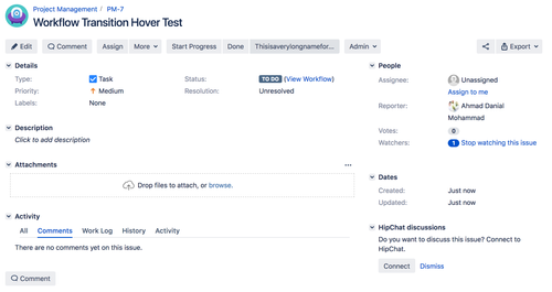

I reproduced in JIRA 7.12.1 and verified that I am seeing similar behavior as the bug report.
However, I would like to take a step back to understand your statement here:
Full transition name is NOT visible when we hover over the button
What I understand here is that despite the fact that you hovered over the button, you are unable to see the complete transition name, unlike what I am seeing on my end. May I know if it is possible for you to provide me with the screen shot(s) from your side to ensure that I am able to reproduce properly together with the transition name as well?

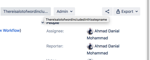

The transitiion name is available on hoover when user is assigned the ticket the first time(through transition post function). When user is refreshing the page or logs in freshly after a first view the tooltip is not visible on hover.
AhmadDanial
December 6, 2018
Hi there, Sahith.
I was able to reproduce the issue on JIRA 7.11.2 & JIRA 7.12.1 where the tooltip is not visible when mouse is hovered on it as you mentioned after the refresh:
I went ahead and created a bug to report this issue to the dev team below:
Feel free to add yourself as a watcher to the bug report and share additional thoughts on it if you have any. Thanks.
