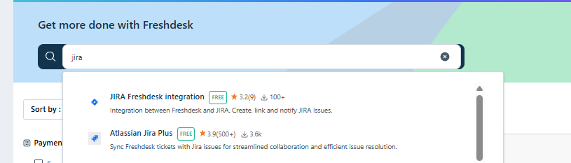

Thanks everyone for the suggestions. I managed to schedule a call with Atlassian Support and it's solved now. In the future, if someone is having similar problem, use Atlassian Jira Plus add on, not Jira, and it should work. It did for me :)
