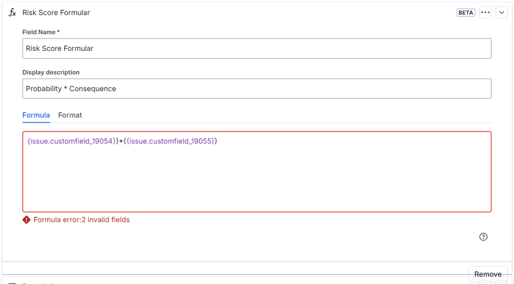

I would like to create a custom field of type “Formula” in a team-managed project. The formula is simple:
{issue.customfield_19054} * {issue.customfield_19055}
Both custom fields are of type “Number”. However, when I try to enter the formula, the fields are always highlighted in red and cannot be saved. I’ve tried various variants, including:
  • {issue.customfield_19054} * {issue.customfield_19055}
  • {{issue.customfield_19054}} * {{issue.customfield_19055}}
  • {customfield_19054} * {customfield_19055}
  • {Probability} * {Consequence}
How do I reference custom fields correctly in a formula?

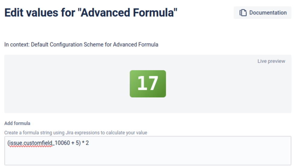

Hi @Moritz Lindenau I can see that you found a solution to your problem, but I'd still like to suggest another one in case at some point you find the native calculated/formula field type limiting or cumbersome to setup.
If you're open to a Marketplace app, Awesome Custom Fields has an Advanced Formula field type that's specifically designed for this kind of calculation. Full disclosure, I am affiliated with the team behind the app.
You can reference other custom fields in your formula and do math operations between them. It features auto-complete for simplicity, enhanced error hints for troubleshooting, and supports custom rendering.
To derive a numerical result from a formula, you can employ Jira Expressions for calculation.
It works on Jira Cloud, including team-managed projects.
Let me know if you have questions about how the formula field handles field references specifically.

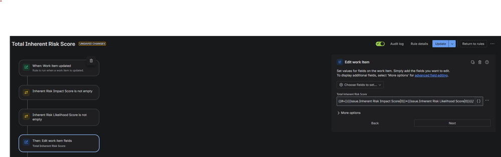

Thank you. Instead of selecting a formula, can you try an automation rule where the THEN Edit Work Item
In choose field to set, find your new custom field
In the box that appears, paste
the formulas I tried above
I believe what this does is input the value as if it were a formula but its not set as a formula field
Ive attached a screenshot of a similar automation I have built which may helpScreenshot 2026-04-22 134207.png

The formular field is already available in our space:
But when I try to use a custom number field for a calculation it does not work:

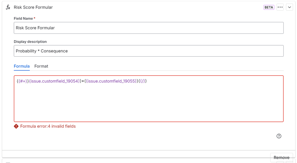

Chris Hampshire
April 22, 2026
Have you tried this formula?
{{#=}}{issue.customfield_19054}}*{{issue.customfield_19055}}{{/}}
Moritz Lindenau
April 22, 2026
Yes, similar outcome:
