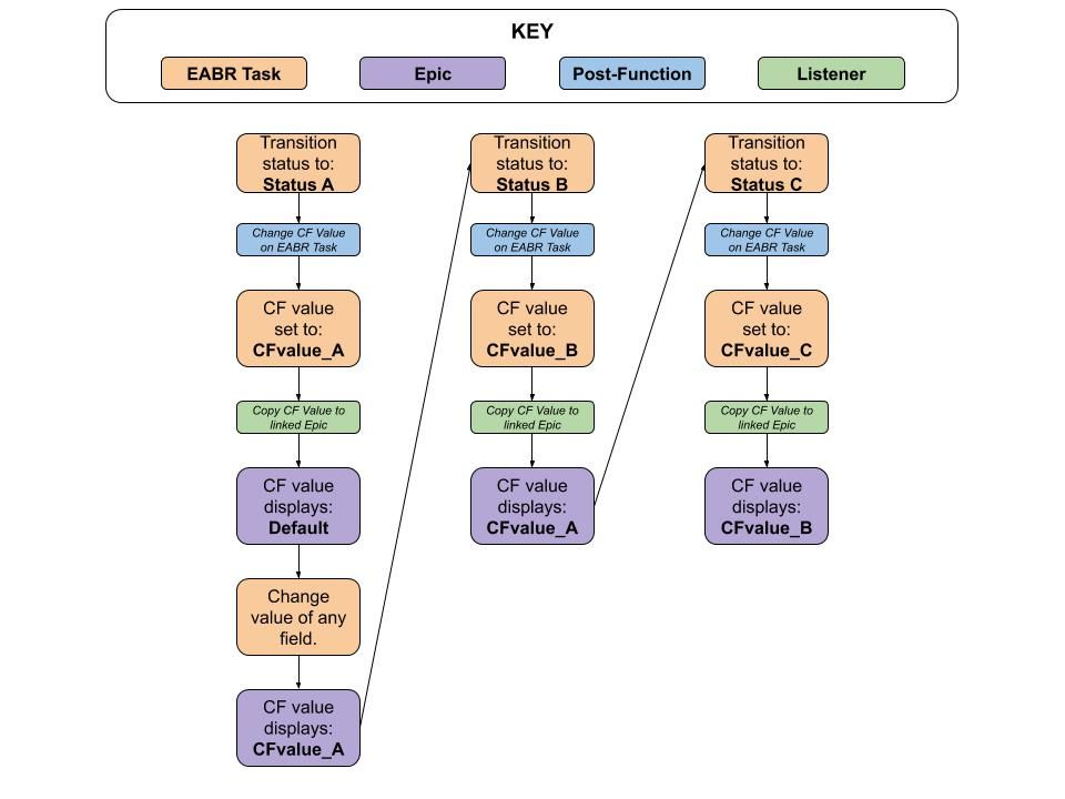

tl;dr.....
Simplified workflow....
  1. Change status on Task
  2. Post-function changes custom field on Task to defined value
  3. Script Listener takes that custom field value from Task and applies it to the same field in the Epic
Simplified problem....
The custom field on the Epic is always 1 step behind that of the Task. I need to update the Task a 2nd time (any field) in order to populate the proper values to the custom field within the linked Epic.
Intended outcome....
Changing the status of the Task, updates the custom field value on the task; then in-turn updates the custom field value on the linked Epic so that the fields are the same.

Shane Labonte
May 13, 2019
To clarify:
  • The Epic is linked to the EABR Task issue type.
  • I am trying to update the custom field for all issues linked to the EABR Task (which is the Epic).
  • The listener should respond to the changes made in the EABR Task and then update that custom field to the same value on the linked Epic issue.

  • I can validate that the changes are applied to the linked issues (Epic) via the line:
    • log.info("New values for updated issue : ${changedIssue.key} ${issue.issueType.name} ${changedIssue.id} ${cfPostIndexValue}")
    • which shows the Epic issue and its custom field value correctly after the first re-index.
  • "...always 1 step behind" is referring to my overall issue that I need to update the EABR Task 2 times before the changes in the custom field are applied to the Epic via the listener.
My apologies for the confusion, you can imagine that this is not easy for me either.
I really do appreciate the consistent help and replies you have provided thus far. Thank you for your time and effort Marc.

Shane Labonte
May 14, 2019
  • Let's say I transition the status of the EABR Task to Status A.
  • The post-function will then change the custom field value on the EABR Task to CFvalue_A.
  • I then navigate to the linked Epic issue and the custom field value will either be set as the default, or have nothing there.
  • I return to the EABR Task issue in the previous step.
  • I change any field in the EABR Task to any value (doesn't matter which field or what the value is).
  • I once again return to the linked Epic issue and refresh the page.
  • I can now see the that the custom field value is updated to CFvalue_A as intended.
This poses a problem in that if the next change made to the EABR Task is changing the status (as opposed to any of the other fields) the custom field in the Epic will have it's value updated, but it will be to the value previously displayed in the EABR Task, rather than the currently set value.
example below:
  • I transition the status of the EABR Task to Status A.
  • The post-function updates the custom field value on the EABR Task to CFvalue_A.
  • I navigate to the linked Epic issue and the custom field value will either be set as the default, or have nothing there.
  • I transition the status of the EABR Task to Status X.
  • The post-function updates the custom field value on the EABR Task to CFvalue_X.
  • I navigate to the linked Epic issue and the custom field value will display CFvalue_A.
  • This persists.......
  • I then once again return to the EABR Task and transition the status to Status B.
  • The post-function updates the custom field value on the EABR Task to CFvalue_B.
  • I once again navigate to the linked Epic issue and the custom field value will now display CFvalue_X (which was set as the previous value on the EABR Task).
This continues even if I change the EABR Task and re-index the entire project. The value will still not be copied properly to the Epic unless I run a 2nd update of any kind on the EABR Task issue.
If it helps to have this visually, I made a flowchart of the process:Jira Script listener Issue.jpg
Marc Minten (EVS)
May 15, 2019
Ok. Where did you put your post function (change of custom field) ? Before and after what other Post functions?
Shane Labonte
May 15, 2019
I currently have the post function to change the custom field on status transition, just before the "Update Change History for an issue and store the issue in the database" step. So, the whole process of a status transition is as follows:
  1. Set issue status to the linked status of the destination workflow step.
  2. Add a comment to an issue if one is entered during a transition.
  3. Custom script post-function (inline script) {my post function}
  4. Update change history for an issue and store the issue in the database.
  5. Re-index an issue to keep indexes in sync with the database.
  6. Fire an Issue Updated event that can be processed by the listeners.
This being said I have tried moving it around to a couple different places within those steps to see if that made a difference, and had no luck.
