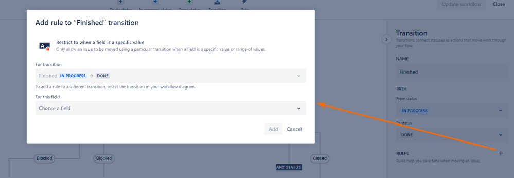

Have you checked the rules that you can add in the workflow section of the settings?
My ideas are:
  1. Add a rule to restrict when a field is a specific value
  2. Add a rule that if a ticket has not been through a specific status it will be restricted.
    • This would need to be followed up by an automation that moves the ticket to the designed status for logged time validation with a trigger on logging time
  3. Create an automation that would revert the status to the previous one if no time was logged.
Let me know if you would like to investigate in any of these options.
Best regards,
Patrik
Trudy Claspill
July 21, 2023
This rule would allow the issue to transition if any time was logged at any point prior to the transition.
This rule would not force the user to log additional time as part of completing the status transition.
In a Team Managed project there is no method to require a user to enter data while making an issue transition because Team Managed projects don't support adding a Transition Screen.
The "Restrict to when a field is a specific value" rule requires you to have entered information in the issue before you attempt to execute the transition.
And, in fact, checking the total time logged for an issue is actually not one of the fields that can be checked with this rule.

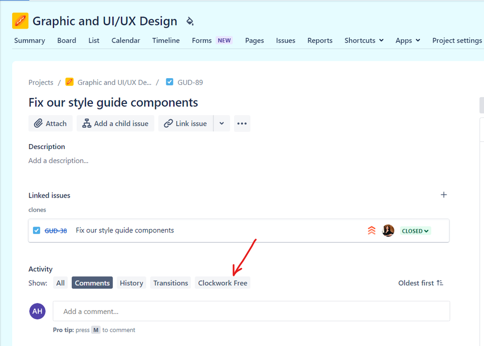

Arthur Harutyunyan
July 23, 2023
Hi @Patrik Korovsky thanks for suggesting that workaround. I will dig in a little bit to try to find a workaround using the automation. I am not that optimistic though, because I am using an external plugin for time logs in my Team-Managed projects which brings more complexity in this flow.
So, I want to somehow force the users to use "Clockwork Free" logging plugin !!
And to answer to @Trudy Claspill the requirement is the following:
The workflow I have for this Team-Managed project is the following:
   ToDo -> InProgress -> Test -> Validated/Reopened
I want to force the users to add a log in "Clockwork Free" once the issue is transitioned from "InProgress" to "Test".
Thanks guys!!
