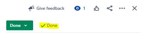

Michael Andolfatto
May 24, 2022
The resolution field is present on all issues and will appear next to the status (green check mark) - Could you verify that on any issue with a strike-through that you do not see something similar to my screenshot? (Even if the status is Backlog)
The resolution field should be the sole thing responsible for this behaviour so if that is not set, I would assume this is a visual bug and would recommend raising a ticket with Atlassian.

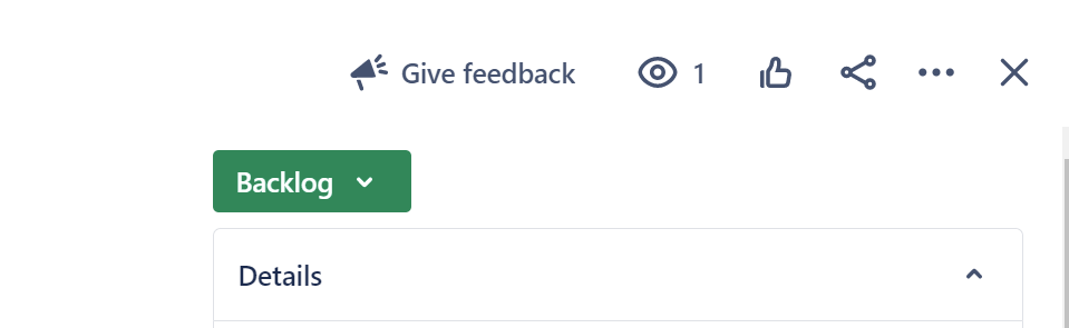

Sucharitha Revanuru
May 24, 2022
The following is what I see on my issue, should I change it to Done, and see if I can see what you have posted above?

Michael Andolfatto
May 24, 2022
Ah so the problem is the status category of the Backlog status. Green represents a "finished" state, and Backlog should really be gray which represents "to do/not started".
I just tested this on my instance, and an issue with a green status and no resolution set also has the strike-through (which did not used to be the case) so to fix this you would need to change the status category.

Sucharitha Revanuru
May 24, 2022
Hi Michael, I have figured out how to change the Status Category, I have changed the BACKLOG status category to 'To do', earlier it was set to 'Done', which is why we are seeing the BACKLOG in green and issue being struck through. It is fixed now. Thank you so much for your time and clear instructions.
