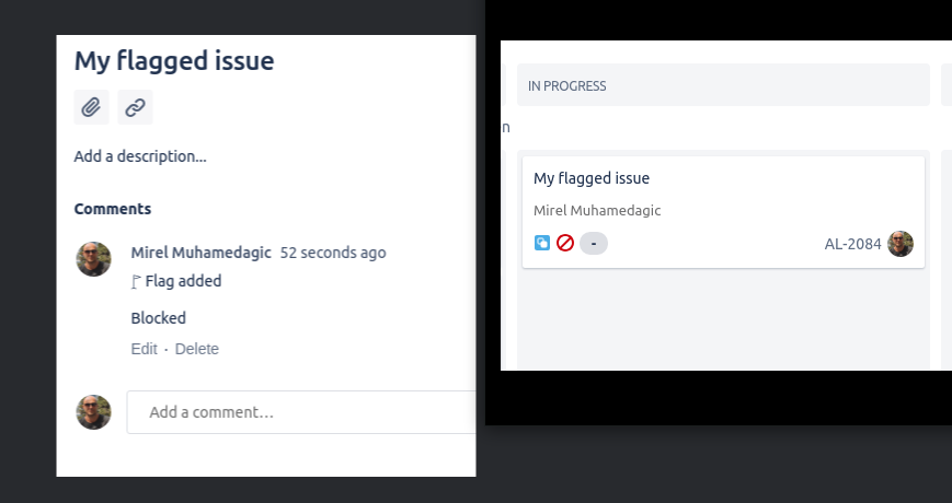

mirelm
May 16, 2018
Thanks for taking the time to reply. As I stated before, I did exactly as you are suggesting. I am expecting to see the icon and change of color on the board but that is not happening. I am attaching a screenshot.  On the left, I see the flag only when I actually click on/open up the issue. On the board, there is no representation of this..issue.png
