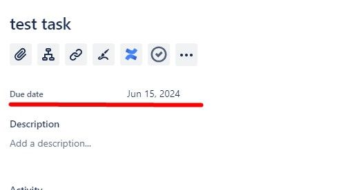

I need help with creating automation when due date for the issue is approaching. I set due date, and I need to automatically flag the task 10 days before it.
In the example below, I need this task to be automatically flagged on 5th June.
Thank you!

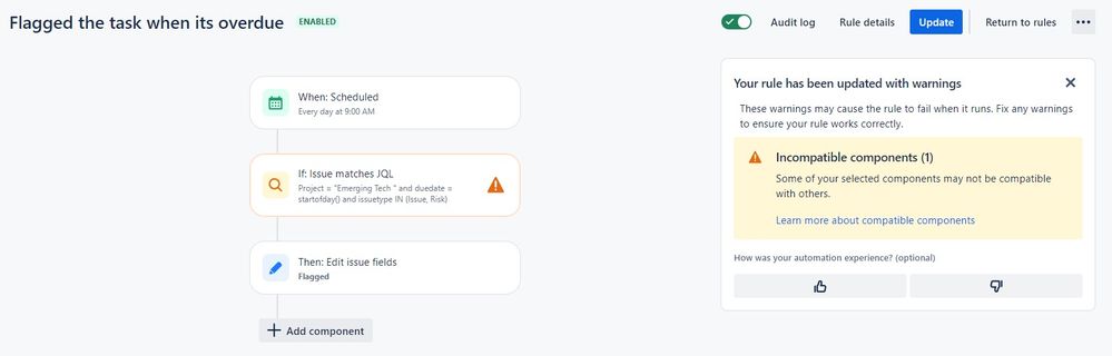

@John Funk  i did the same as you suggested but it does not work it says
Incompatible components (1)
Some of your selected components may not be compatible with others.

Hi @Mohammed Ansaar -- Welcome to the Atlassian Community!
That new error message can be a bit confusing...what it indicates in this case is the rule uses actions which need issues but the trigger did not supply any issues.
Please check your Scheduled Trigger as it appears to be missing the JQL to supply the issues.

Did you check if the Scheduled Trigger has JQL?
If it does not, that is the cause.
