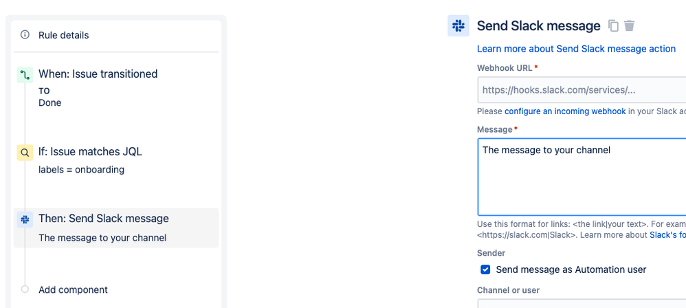

And yes, you can have multiple notifications going to the same channel. Here is what I would do. Keep the original automation, which I assume is triggering on Issue create and then create a new one that is triggered on the transition to Done, something like this:

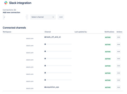

Hi @Mikael Sandberg ! Thank you so much for your response. And I apologize if this is a simple question, I'm learning as I go! but I do not have the same view you do. I am looking at this one:
How can I find your view?
Also is it easier to just update the JQL instead?
Thank you!

Ah, I forgot about the Slack integration. From there you can only have one connection to each channel.
My view is from Automation, you get to it if you go to Project settings > Automation and from here you can create rules. And automation do not have the same limitation as the Slack integration, but you would need to create an app in Slack that accepts incoming webhook. But that is really simple and Slack's documentation has an example for it.

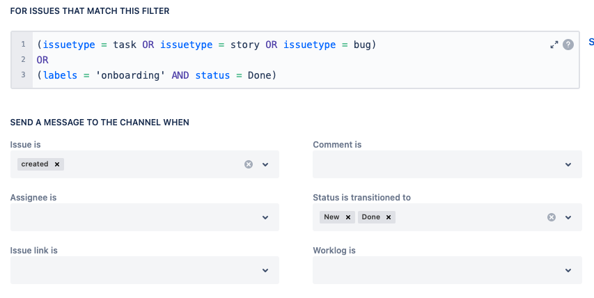

If you want to keep using the Slack integration then the integration should look like this:
Note that you would have to trigger on the status transition, you cannot use the Issue is option since you are covering two different events.
I prefer using the automation because you can then control what is being included in the message sent to Slack and you are not limited to a single integration.

Hi @Mikael Sandberg , after a few days of making sure all is working correctly, this is complete, thank you!!
Note: I did have to remove the quotes around the Onboarding label, but other than that, it worked!
