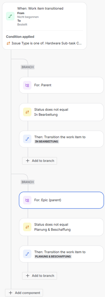

Hi, I have created an automation with the purpose of once a subtask is transitioned to status "bestellt" (meaning 'ordered) to update the status of its parent task but also epic.
Problem 1: the custom-created epic we named "Auftrag" does not get updated in this automation, whereas the parent (task) does correctly
Problem 2: we use several subtask types and I need to know how to narrow this automation down to only apply for the first subtask being transitioned to status "bestellt"

Hello @Harald Heinz
For your problem 1:
This is because a subtask does not have a direct relationship with an Epic, so you cannot perform the branch For Epic. This branch only applies if you run it on a child of an Epic (e.g., a Story or Task).
For your problem 2:
I don’t understand. If the first subtask transitions to Bestellt, automation will transition the parent to In Bearbeitung. But the next time it fires, you have the condition “if the parent is not In Bearbeitung, so the action will not run again.

Marc -Devoteam-
August 29, 2025
Hi @Harald Heinz
This is not doable in a single rule, as the trigger of the rule is the sub-task.
So indeed it's parent will be updated, as you stated,
The Epic will not as the trigger of the rule is the sub-task, not the child of the Epic (Story, Task, etc..).
You will need a second equivalent rule that triggers on the update off the Story, Task, etc.., to transition the Epic.
Note: make use to check the checkbox that the rule can be triggered by another rule.
Bill Sheboy
August 29, 2025
Hi @Marc -Devoteam-
FYI -- this can be done with one rule with Jira Cloud, but that is not a general solution...
The solution is to first branch to the parent for the update (which gets substituted with inline code and avoids parallel processing), add a re-fetch (or delay) for a pause, and then use a JQL branch to update the grandparent Epic.
