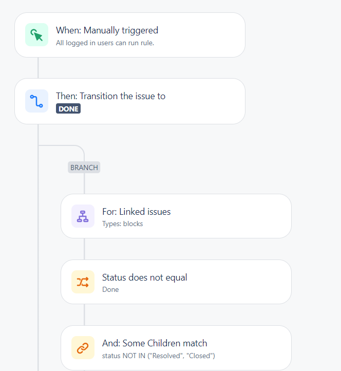

Can you help me with mine? I am trying to find the linked issues of a linked issue and check the status and then transition them.
I have a Manual trigger that closes an issue and then a branch to check the FOR Linked issue of type "blocks" and close any child related tickets on that linked issue. That linked issue also has linked issues of "relates to" type but I can't get to it to check. I can reach the Child tickets of the linked ticket but not the linked issues of that linked ticket. I have tried using the related issue condition for sub-tasks and linked issues.
