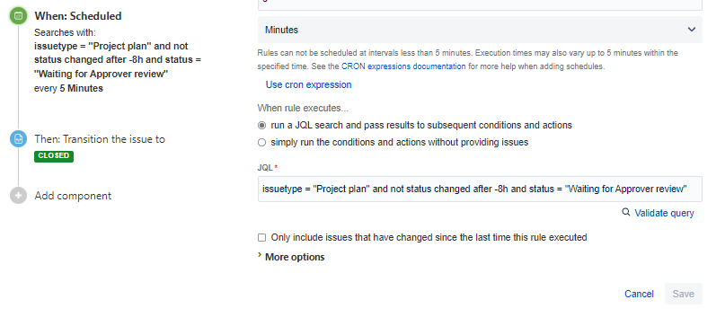

Hi guys,
Before, I ve used not status changed after -8h to find issue where status has been not changed for 8. But now, I need it is 8 working hours (8h30 - 12h and 13h30 - 17h30)
Could u pls give me some advices
Thanks for your support

Hi @Tuncay Senturk _Snapbytes_
Thanks for your reply
We re using Datacenter (Jira Software). I intend to create an automation that can close issues when their status have not been changed after -8h (but for work-hours)
Pls tell me how to use script runner for this case?
Thank you so much
