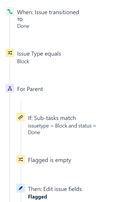

I send you a picture of how the automation you said should be (to verify that I am correct)
Even so, the automation does not work for me, there is the possibility that in addition to having blocking-type subtasks it also has "normal" subtasks (the ones that come by default in jira). However, the automation I'm looking for is independent of Jira's subtasks and specific to the blocking one.

Hi @[deleted]
Looks like I made a minor error in Rule 2 - the Branch logic should be...
  • Branch: Related Issues = Parent...
    • Condition: Related Issues Condition
      • Related Issues: Sub-tasks
      • Condition: All match specified JQL
      • JQL: issuetype = Block AND status = Done
    • Condition: Issue Fields Condition
      • Flagged is not empty - correction added here
    • Action: Edit Issue
      • Flagged = NULL - leave it empty
I've corrected this in the original answer also.
The rule is specific to "Block" sub-tasks, and should ignore the normal sub-tasks because of the JQL in the Related Issues Condition - which stipulates that it's only relevant to "Blocks".

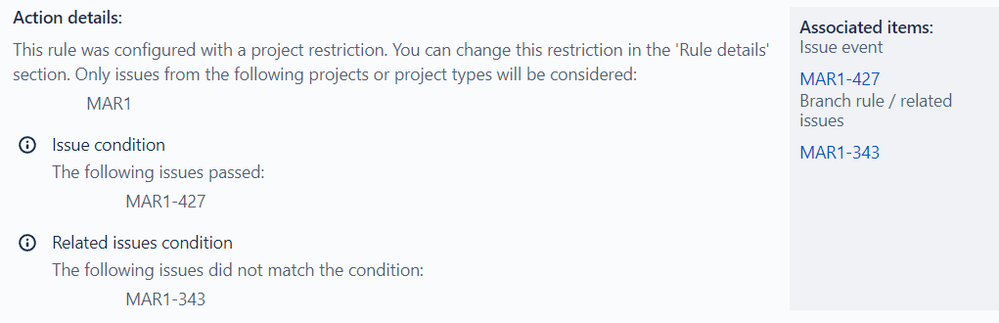

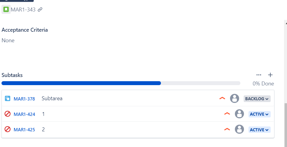

Deleted user
May 7, 2022
Hi @Ste Wright
Automation still doesn't work :/
I just did the test when I only have blocking type subtasks and not the "normal" ones and the rule works fine. However, it is not the solution I am looking for.

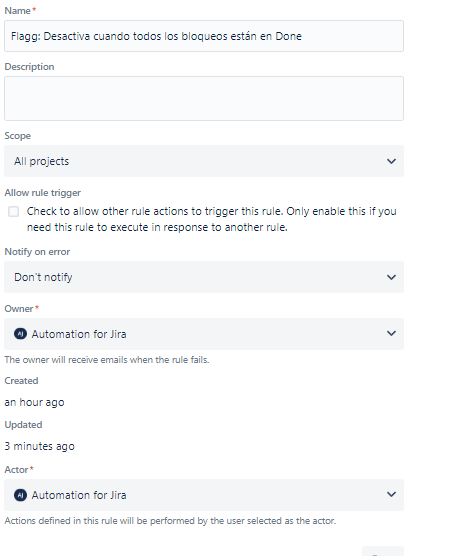

Now I ran into another problem, when I try to leave myself as a global rule for about 8 projects it doesn't work :/
I tried all the ways in the scope section but still did not have good results

May 10, 2022
@Ste Wright Any idea why the automation doesn't work?
