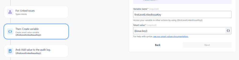

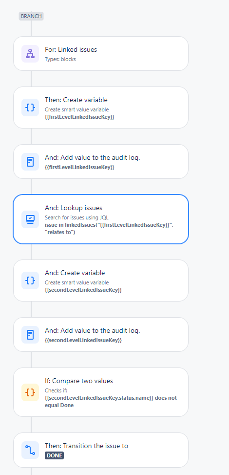

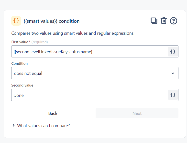

Thanks, Bill! So I ended up doing a lookup in the branch and I am getting to the linked issue that I want now per the log actions but then when I do the comparison of the smart-value, its still grabbing the first linked issue. Just wanted to see if you had any ideas here if not no worries.
issue in linkedIssues("{{firstLevelLinkedIssueKey}}", "relates to")

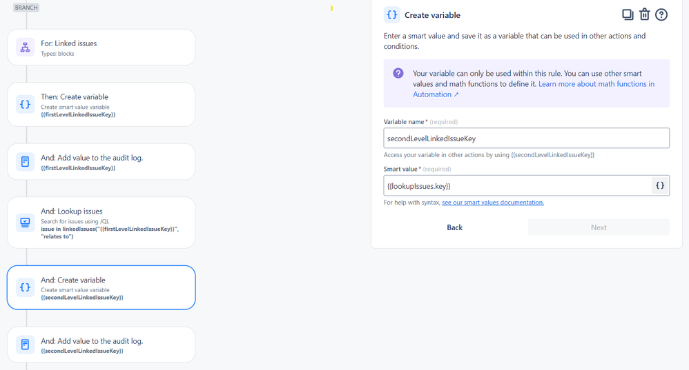

Certainly! Here it is:

First for those writes to the audit log, please add some labeling to confirm what we are observing.  For example:
firstLevelLinkedIssueKey: {{firstLevelLinkedIssueKey}}
Next, for more context please show images of the entire updated automation rule and of the entire audit log details for that rule execution.  Those will help distinguish which issues are being acted upon in the rule steps.
Natasha Richardson
July 31, 2024

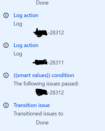

OK, sorry I thought that was what you needed. Yes 28312 is the firstLevelLinkedIssueKey and 28311 is the secondLevelLinkedKey so it's finding the correct issues but for whatever reason the smartvalue condition check is referencing 28312 when it should reference 28311 from the lookup. But I actually am thinking of going in another direction altogether because I think this is getting too complex. I am going to just link the issue I need to the issue I am running the manual automation against and then check the status from there.
