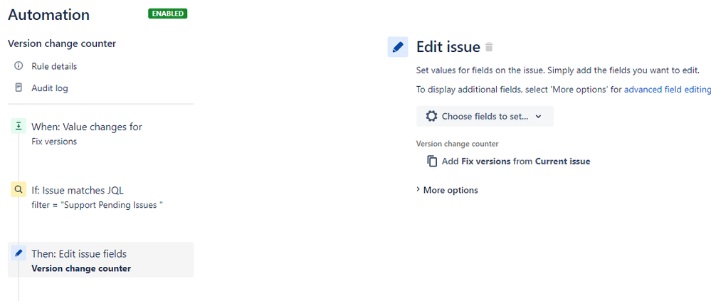

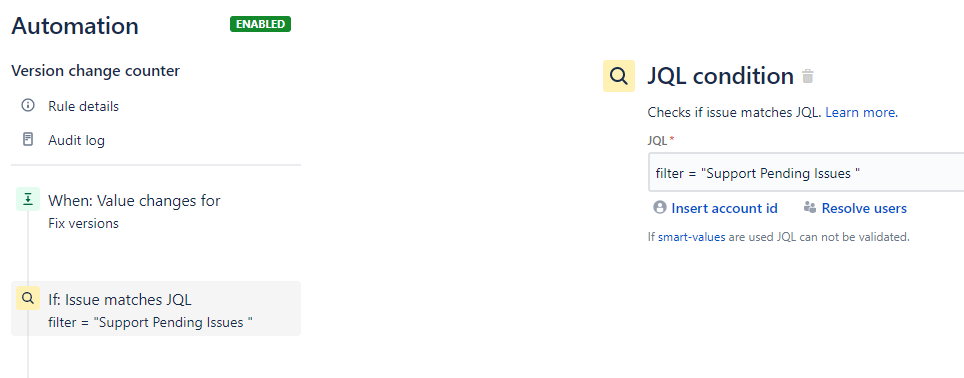

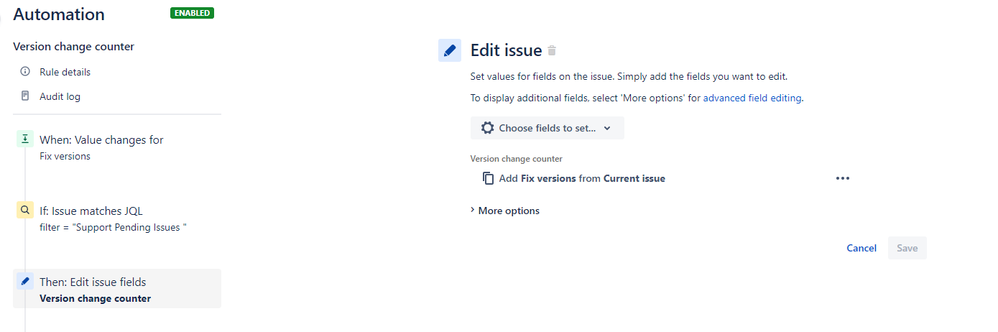

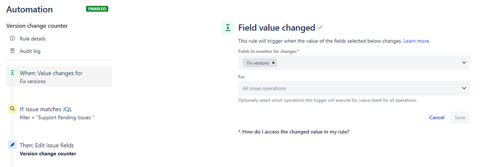

Hi @Trudy Claspill and @Daniel Turczanski - JQL Search Extensions ,
Thanks for your suggestions.
I did what you have suggested but still not work.
Please see attached PrtScn with the rule definition.
In picture #2, you can see the JQL condition - Only if the current issue is part of the returned issues of the saved filter, then edit the issue.

So, you are saying the rule is not working as you expect it to. How is it not working?
Is it not updating issue you think it should?
Is it updating issues you think it should not?
Is the rule getting triggered at all?

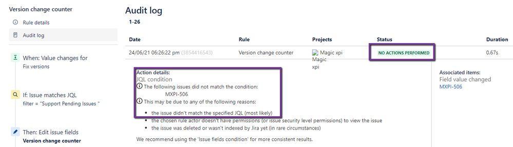

Show us the Audit Log for an instance where the rule is triggered and you don't get the desired results.

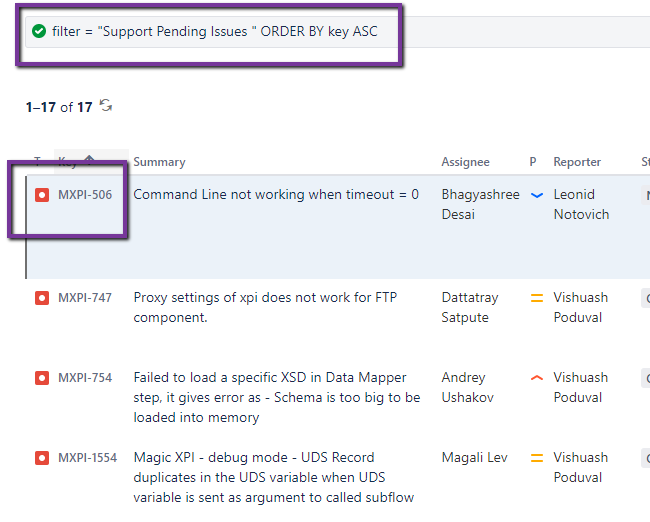

Hi @Trudy Claspill ,
thanks for your fast response.
As you can see, issues Key MXPI-506 is returned when executing the saved filter
So it should meet the condition
and the issue should be edited
But not working

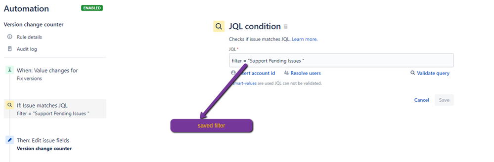

I tried something similar.
In the JQL condition if I used
filter = "name of filter"
...then I got the same results that you did. I even clicked the Validate Query link on the condition and it said it found matching issues.
If instead in the JQL condition I put the actual criteria of the filter, i.e
issuetype = Bug and project=ABC
...then the filter executed successfully and the Actions in it worked correctly.
