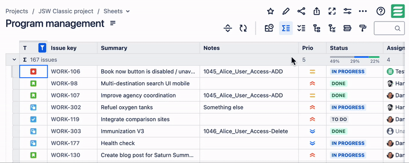

E.g., your use case would be trivial to solve using the app that my team and I are working on: JXL for Jira.
JXL is a full-fledged spreadsheet/table view for your issues that allows viewing, inline-editing, sorting, and filtering by all your issue fields, much like you’d do in e.g. Excel or Google Sheets. One of the filtering options that is available for all fields is text filtering, which performs a partial match by default.
This is how it looks in action:
For more advanced use cases, you can also use logical operators (AND, OR, NOT) as well as regular expressions.
