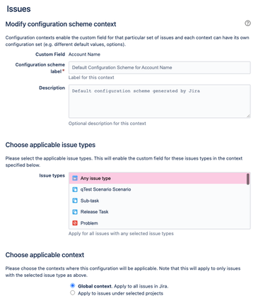

Since my team-managed project's issue types are all specific to that project, they don't show up in the "Choose Applicable Issue Types" list in the Modify configuration scheme context page, so I selected "any issue type", see a screenshot below.

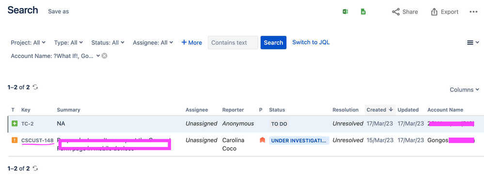

I then wanted to filter my issues by Account Name, and when I added this field, still, everything worked fine, you can see that it returns 2 tickets - #148 belonging to my project.Screenshot 2023-03-17 at 14.22.19.png

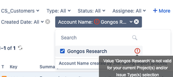

But if I try to apply the filter only to my project (instead of having project:all), a weird message pops up saying that my value is not valid in my current project or issue selection?

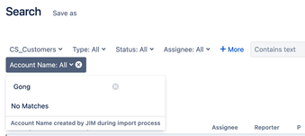

I've even tried to first select my project and only then filter by the Account Name but no matches show up...

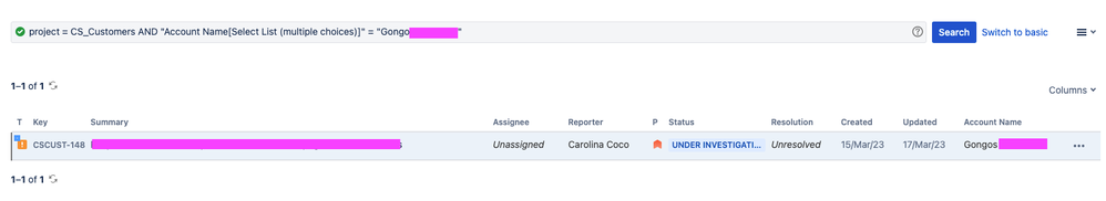

3. Simplify your JQL query: this worked!!
project = CS_Customers AND "Account Name[Select List (multiple choices)]" = "Gongos"Screenshot 2023-03-17 at 15.08.58.png
