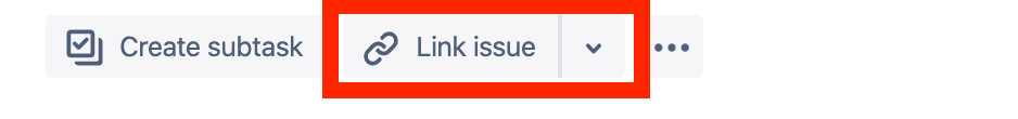

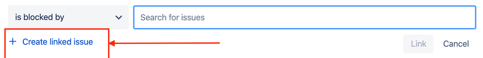

Also, what I am trying to achieve is. See below:
1. I have a project called -> INC and tickets in this project are linked to a project called 'Snyper' by creating a 'Linked ticket' option. So I need a filter where I can see all tickets created in the 'Snyper' project using the 'Linked ticket' option in the 'INC ' project.

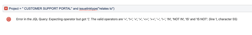

issueLinkType in (contains,"relates to")
But I get below error, please forgive me I am new to Jira :
My previous answer was just an example you need to replace the linktype with the one you use, so in you case is
Issuelinktype("is blocked by", "blocks")
