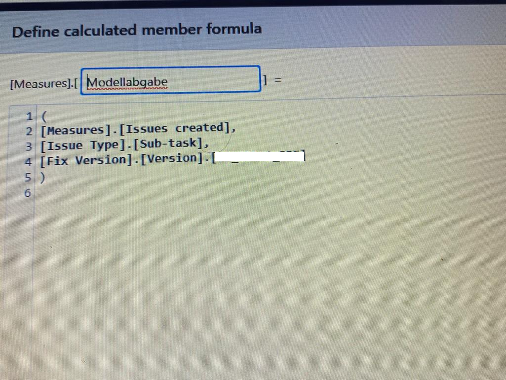

Hi,
I am pretty new to eazyBi.
I wanted to filter all subtasks with a particular version and subtask name  includes "XYZ". How can i do this in eazyBi dashboards?
I have defined a new calculated measure with issue type as subtask and version.
How can i include the subtask name contains "XYZ" also into this measure or maybe create a new measure ?
Please find the attached screen short
Thanks,
Alokh R

Hi @alokh ram,
​If you need to filter out issues based on a loose condition with several possible members, a tuple will not work.
​In that case, you need to process the set of filtered issues.
​The code fragment for filtering the set might be as follows.
Filter(
--generate set of issues
DescendantsSet([Issue].CurrentHierarchyMember, [Issue].[Issue]), --filtering conditions ([Measures].[Issues created], [Issue type].[Sub-task], [Fix version].[<path to specific version>]) >0 AND [Issue].CurrentHierarchyMember.Name matches ".*XYZ.*" )
​You might then process the filtered set by counting members, summing, or averaging necessary measures.
​Regards,
​Oskars / support@eazyBI.com

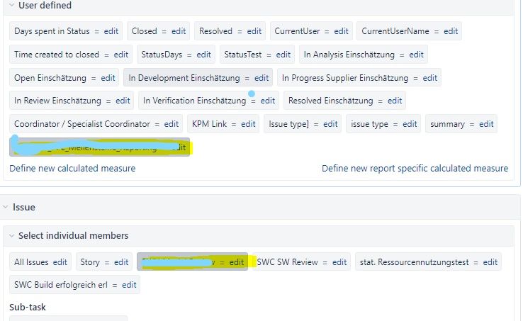

alokh ram
June 20, 2022
@Oskars Laganovskis Thank you for the response.
Can i create a single calculated measure under user defined measures option and include these code and it will work ? But in this case i am getting an error.
Please find the below screenshot what i have created and it works fine now.
In this case i have created 2 separate calculated member one for filtering fix version and issue type as sub task, and another for filtering the specific string.
Please let me know your thoughts
