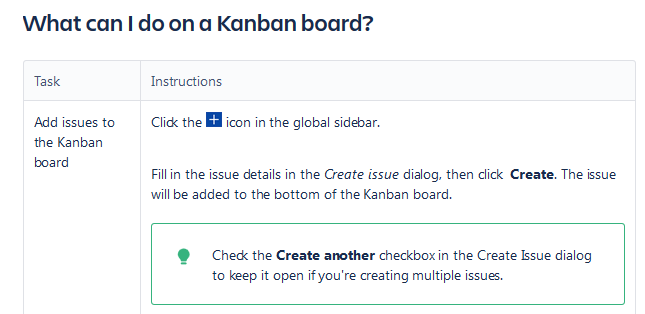

Well it says "Add Issues to the KANBAN Board" in the documentation, so I thought somewhere in the metadata there might be a link, not only to the project, but also to the board the Issue is connected to, see screenshot
I am identifying issues as belonging to topic_1 with their place of creation: If an issue was created in board_1, it belongs to topic_1, etc.

That's a poorly written phrase which suggests boards might be containers.  This is wrong.  I would have written something more like "A quick link to create issues from the board"
Especially as you could create issues that do not go into a board (For example, if you have a board based on "label = x" and you don't put label x on the new issue when you create it)
That does not work because the board is a view, not a container.  If you want separate boards to show different sets of issues, you need to tell Jira how to identify them as different sets, and then set the board filters to understand the data.
