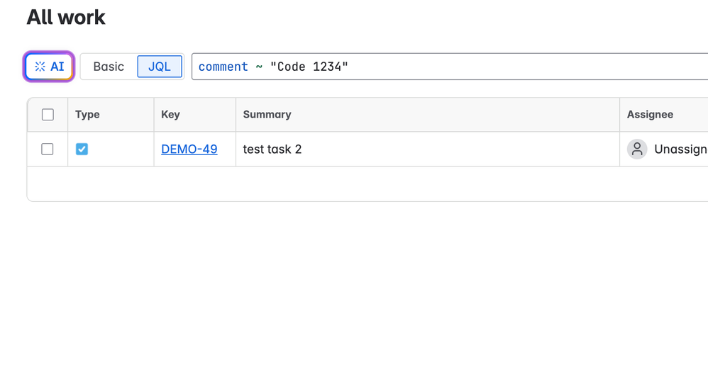

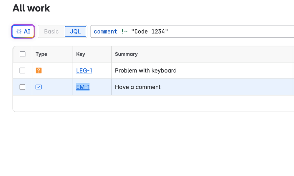

arielei
June 16, 2025
Hey @Dave Stillwell
I did a test on my end with the same values your wrote, for me it works.
Dave Stillwell
June 16, 2025
@arielei
It looks like you are using JSM/Jira for the cloud.  I wonder if it is because I am using Data Center.
I'll create some dummy tickets in my test environment to do some more testing.
