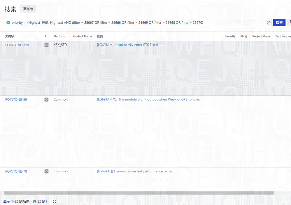

I created a filter statement in jira as follows:
priority in (Highest-最高, Highest) AND (filter = 25667 0R filter = 25666 OR filter = 25669 OR filter = 25668 OR filter = 25670)

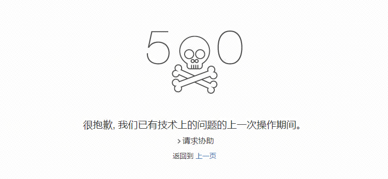

The displayed result is normal, but when I save and share with others, the interface prompts an error, as follows: When I visit this filter again, I also visit 500 errors, I would like to ask what is the specific reason

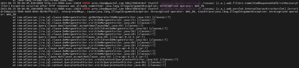

I inquired in the log according to what you said, and did prompt an error. The error information is as follows

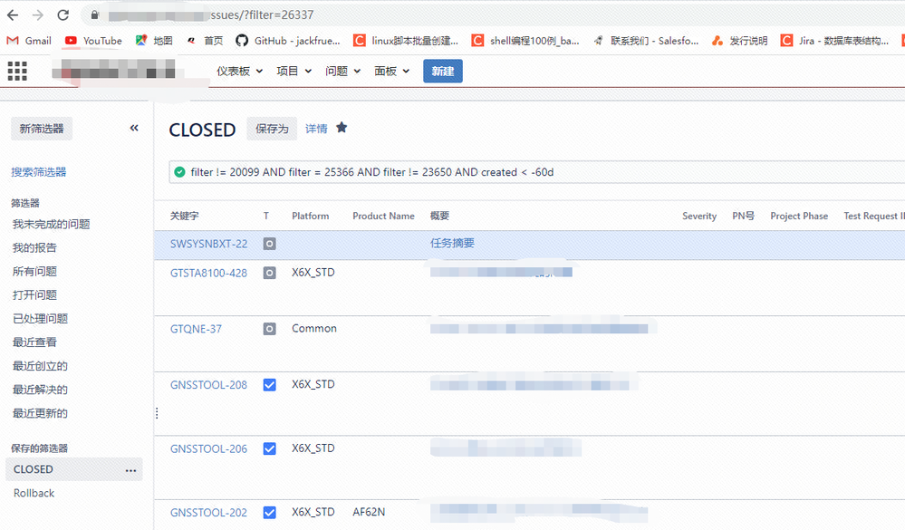

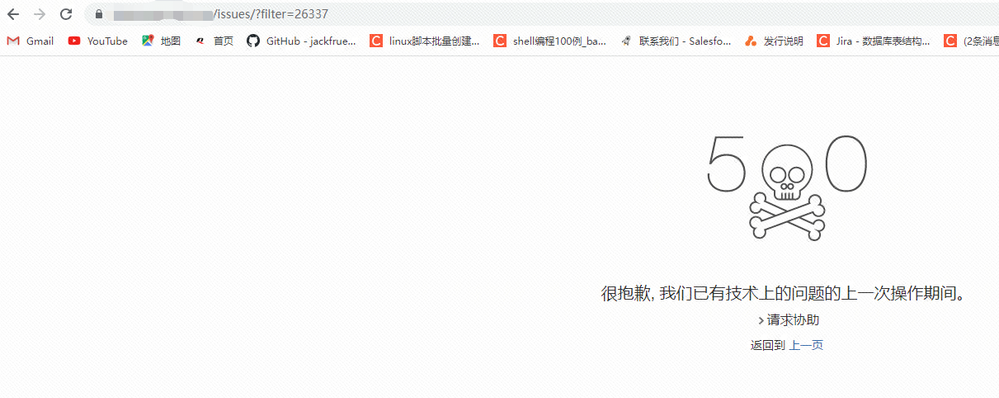

In addition, I checked each filter, and the JQL statement for one filter is (filter! = 20099 AND filter = 25366 AND filter ! = 23650 AND created < -60d), this filter access will prompt the same error, when I create a filter myself, use this query, I directly access the corresponding link (url/issues/? filter=26337), and an error message is also displayed, but I can find the corresponding result

Kind of self-explanatory in that case. One or more of the filters contains "WAS_IN" operator which is not supported.
