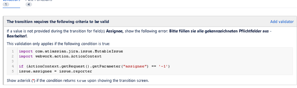

Hello to the whole community,
when choosing a validator I use the one that the requires Assignee field and for some reason I don't get an red symbol on the start page. An asterisk indicates required fields, which means that the validator does not do its job either. Has anyone had similar problems?

David Fischer
November 12, 2020
As explained in the documentation, the appearance of the asterisk is determined when the form is openedi, based on the result of the conditional validation script,  and won't be updated when you modify values on the form.
However, validation will still happen when you submit the form, even if the asterisk is not showing.
David Fischer
November 12, 2020
Also, I noticed you have an = operator instead of == in your script.
Jurica Petricevic
November 12, 2020
Hi David, John,
here it is:
test1JMWE.PNGThere is no asterisk at the Create Display.

David Fischer
November 12, 2020
Can you share the configuration of your Validator?
