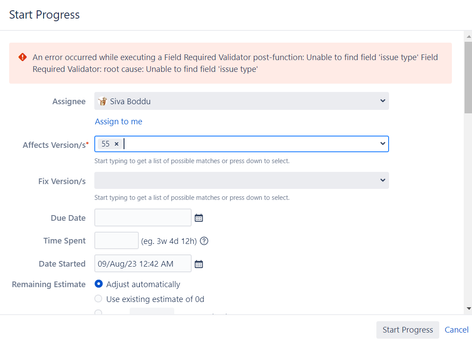

Thank you for your prompt response, and I have replaced the script with the
 issue.parentObject?.get("issue type")?.name == "Story"
And when you try to move the status, it displays the error notice shown in the screenshot below. And here's the script I used in the validator. Please advise me on this matter.
(issue.get("issuetype")?.name == "Sub: Task" && issue.parentObject?.get("issue type")?.name == "Story") && (ComponentAccessor.getGroupManager().isUserInGroup(currentUser, "Siva Apple1") || ComponentAccessor.getGroupManager().isUserInGroup(currentUser, "Siva Apple2") || ComponentAccessor.getGroupManager().isUserInGroup(currentUser, "Siva Apple3"))
Thanks,
Siva.
David Fischer
August 8, 2023
Hi @siva
Sorry, autocorrect on my phone added a space between "issue" and "type" in my snippet. I have corrected it above.
