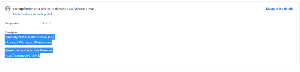

Sebastien Pierron
October 21, 2022
Hi Mark.
Thanks for ur help
Here an example : 2022-10-21_16h05_20.png
Thanks a lot,
Regards

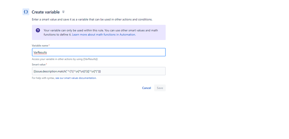

Provided your description structure is consistent, this is what I came up with (someone better at RegEx than me may have a better approach):
Explanation
  • varResults pulls in that second line of text.
    • {{issue.description.match("^(?:[^\n]*\n){1}([^\n]*)")}}
  • varErrors parses the Error count
    • {{varResults.split(" ").get(0)}}
  • varWarnings parses the Warning count
    • {{varResults.split(" ").get(2)}}
  • If Block is looking for whether the total errors and warnings are greater than 0
    • {{#=}}{{varErrors}}+{{varWarnings}}{{/}}
      greater than
      0
The Assignee blocks are just placeholders, but they should give you a sense of how you can handle routing to Engineering/SD.

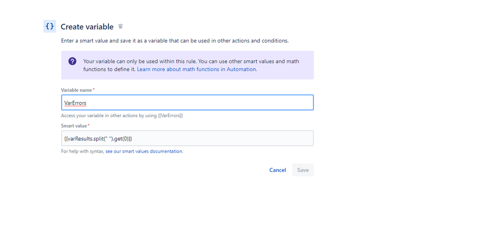

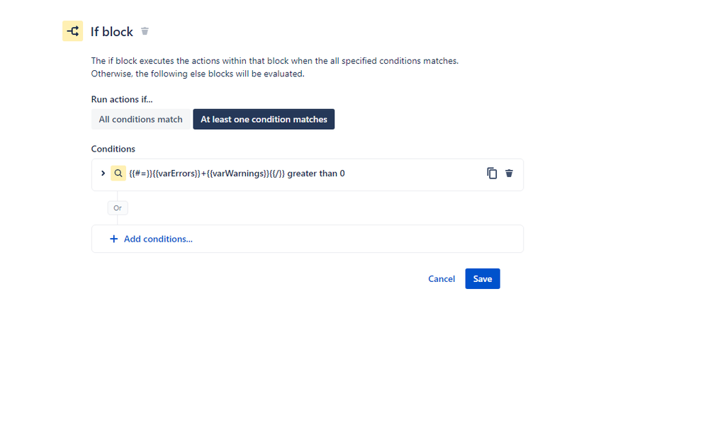

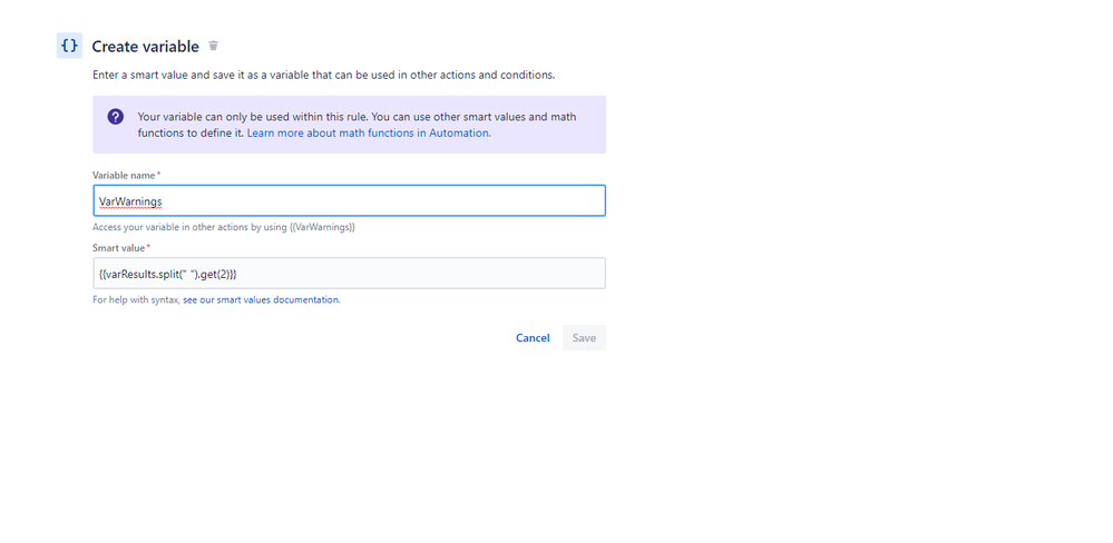

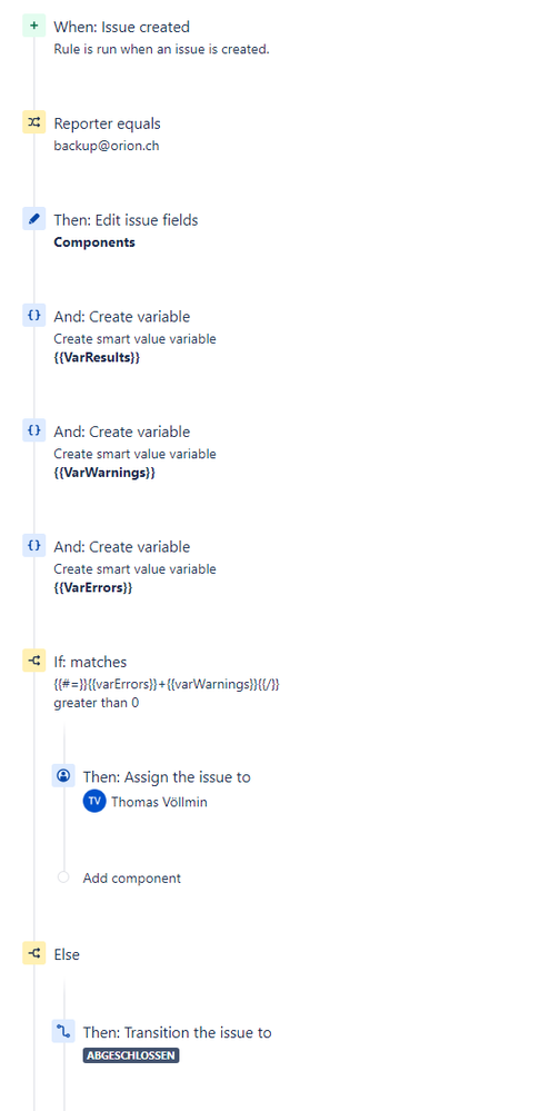

Sebastien Pierron
October 24, 2022
Hi,

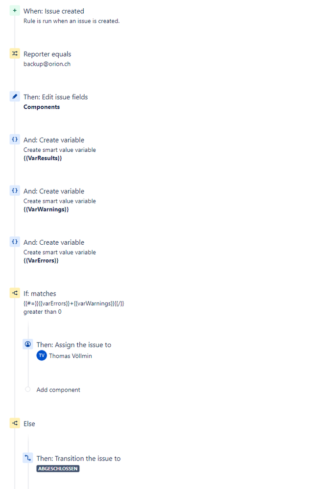

I tried like this, is it correct ?
Mark Segall
October 24, 2022
This looks right to me.  Is it working for you?
Bill Sheboy
October 24, 2022
Hi!  I suspect that may not work for a couple of reasons...
1) Smart values are name, spacing, and case sensitive.  You defined the variables as {{VarResults}} {{VarWarnings}} and {{VarErrors}} but then sum them in lower case as {{varResults}} {{varWarnings}} and {{varErrors}}  Please try changing one of them so they match case.
2) Created variables are text values, and so to use them as math operands, add asNumber, such as: {{VarWarnings.asNumber}}

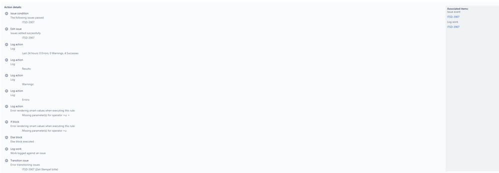

Mark Segall
October 25, 2022
Hmm... This worked in my test environment.  Can you share a screenshot of error messages in the audit log?
Sebastien Pierron
October 25, 2022
Hello Mark,
It just indicates that it passed the issue.
Here some screnshot 2022-10-25_15h10_17.png2022-10-25_15h10_20.png2022-10-25_15h10_23.png2022-10-25_15h10_27.png2022-10-25_15h10_12.png

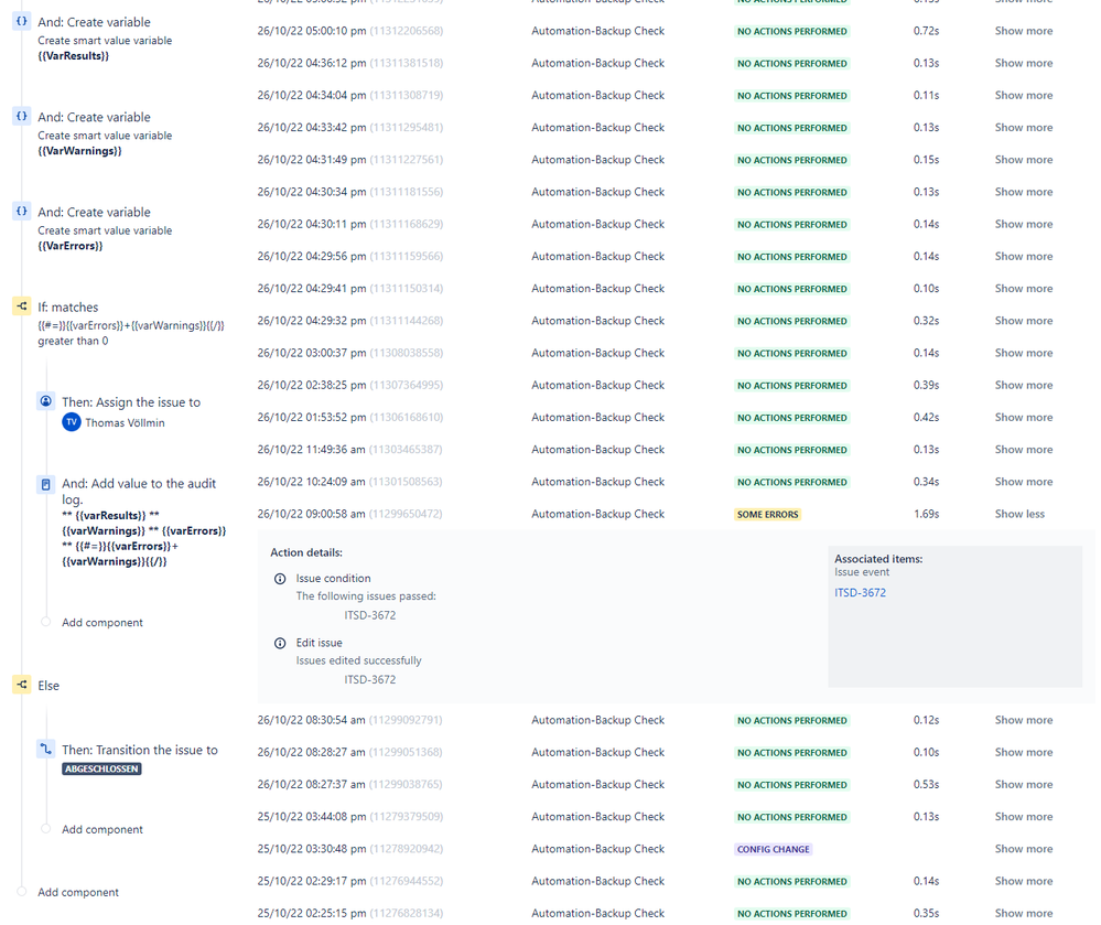

How about this... Let's add an audit log action right after all of the variables with the following:
** {{varResults}} ** {{varWarnings}} ** {{varErrors}} ** {{#=}}{{varErrors}}+{{varWarnings}}{{/}}
This should tell us if the data is being parsed properly.
Sebastien Pierron
October 26, 2022
Hello Mark,
Thanks again a lot for ur help,
Still didn't work yesterday, saldy
Print screen here :
Mark Segall
October 27, 2022
Please see my last comment.  I'd like to add a log action to the rule so we can see if the data is being parsed properly.  Place it right before your If condition
Like Bill Sheboy likes this
Bill Sheboy
October 27, 2022
Yes, and...the capitalization of the created variables is different and that could lead to mismatch.  They should be the same.  Specifically:
  • defined as VarResults but used as varResults
  • defined as VarWarnings but used as varWarnings
  • defined as VarErrors but used as varErrors
Like Mark Segall likes this

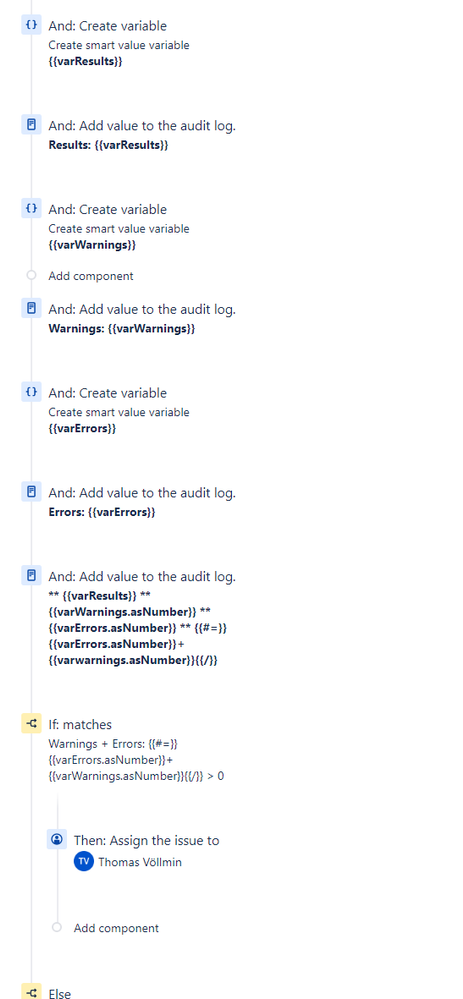

Let's not give up on this just yet.  It looks to me like there may be some tweaks to the variables.  Can you do me a favor and create three log entries?  I think one of the variables is not returning anything, causing the error in the log.  Let's try this:
Log Action 1
Warnings: {{varWarnings}}
Log Action 2
Errors: {{varErrors}}
Log Action 3
Warnings + Errors: {{{{#=}}{{varErrors}}+{{varWarnings}}{{/}}
This will help us identify what is not parsing correctly.  It may be a simple tweak to adjust the split parameter on Warnings or Errors.
Bill Sheboy
November 2, 2022
Yes, and...created variables are text and not numbers.  So please also add asNumber to convert them for math operations.  Perhaps like this for Mark's suggested Log Action 3
Warnings + Errors: {{#=}}{{varErrors.asNumber}}+{{varWarnings.asNumber}}{{/}}

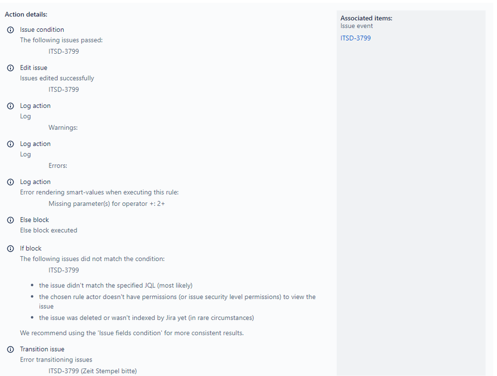

Sebastien Pierron
November 3, 2022
Hello Mark, Bill,
Here is the error message we got this morning,
Thanks for your help
Mark Segall
November 3, 2022
Ok - So it looks like there's something off in the parsing.  Can you add another log entry for
Results: {{varResults}}
This will tell us whether (1) regex is pulling the correct line and (2) if it is maybe the splits need to be adjusted for varWarnings/varErrors.
We're getting closer to finding the root cause

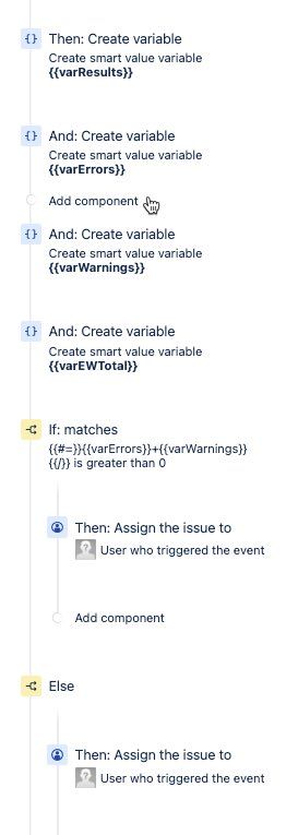

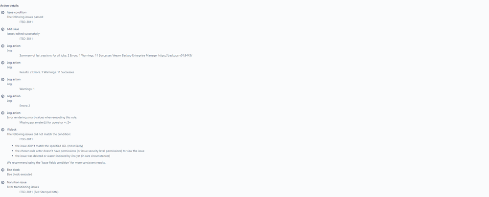

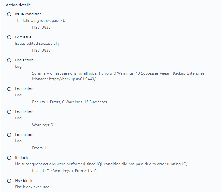

Sebastien Pierron
November 4, 2022
@Mark Segall  and @Bill Sheboy
Once again thank you very much for your help.
Here the screenshot requested
Once again, thanks for ur help
Have a nice eve and week-end
Sebastien
Bill Sheboy
November 4, 2022
Hi @Sebastien Pierron
For the log message which shows the error, what are you trying to write?  Is it one of these:
Warnings + Errors: {{#=}} {{varErrors}} + {{varWarnings}} {{/}}
or
Warnings + Errors: {{#=}} {{varErrors.asNumber}} + {{varWarnings.asNumber}} {{/}}
Please note my earlier post had too many curly brackets at the front.  Sorry about that!
Mark Segall
November 4, 2022
Yeah this is a really good read-out that shows everything is getting parsed properly.  It's all about the math.  I didn't need the asNumber in my test environment, but agree it should at least be tried here.
Sebastien Pierron
November 7, 2022
@Bill Sheboy @Mark Segall
I think we are getting close to the solution
Here are the last logs :
Have a great Day,
Best regards,
Sebastien

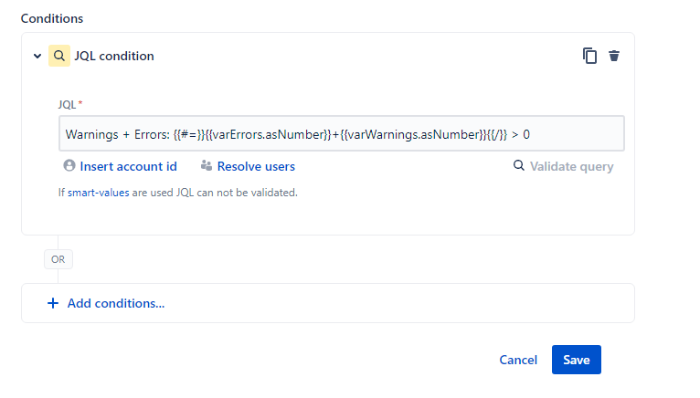

Bill Sheboy
November 7, 2022
Hold on...You are pasting the value in the IF condition as JQL, when that was meant to be logged.  That definitely will not work.
If that was intentional, instead please trying using an advanced compare condition:
  • first value: {{#=}} {{varErrors.asNumber}} + {{varWarnings.asNumber}} {{/}}
  • condition: greater than
  • second value: 0

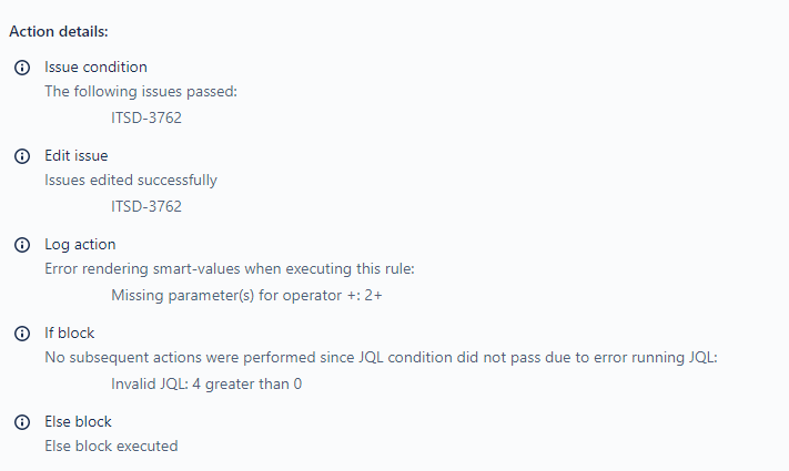

Sebastien Pierron
November 10, 2022
Hello Bill, Mark,
I changed it like Bill asked,
here is the result this morning :
Thanks a lot
Mark Segall
November 10, 2022
It looks like the format of your Description changed?  The solution was predicated on the Description remaining static.
Note that the result comes in as:
Last 24 Hours: 0 Errors, 0 Warnings, 4 Successes
Previously it came in as this:
Summary of Last Sessions for all jobs
For this to work, it must be consistent or the parsing will get really complex.
