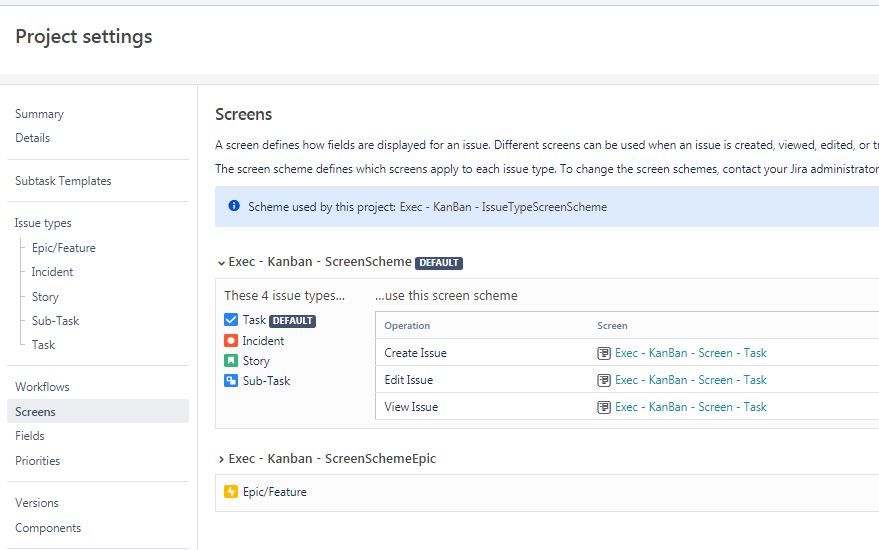

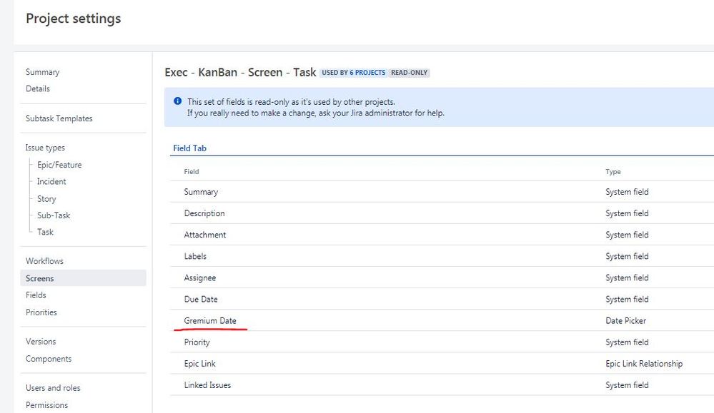

I am having the problem that I can only set system fields (due date, summary, assignee,...) in Shary.
I would like to set the field "gremium date", which is on "create issue screen" the screen in Jira. But in Shary I still get the message
