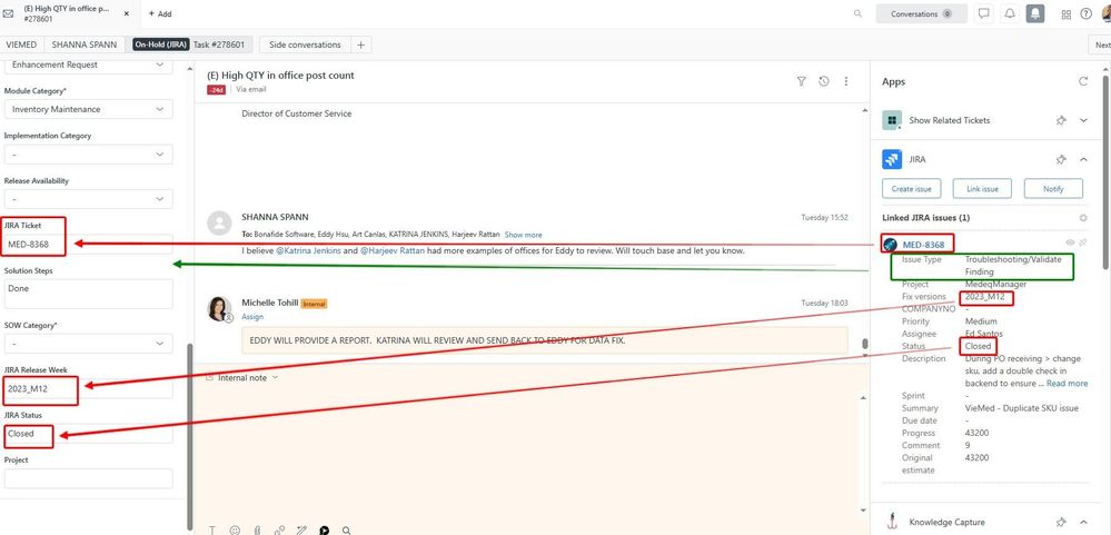

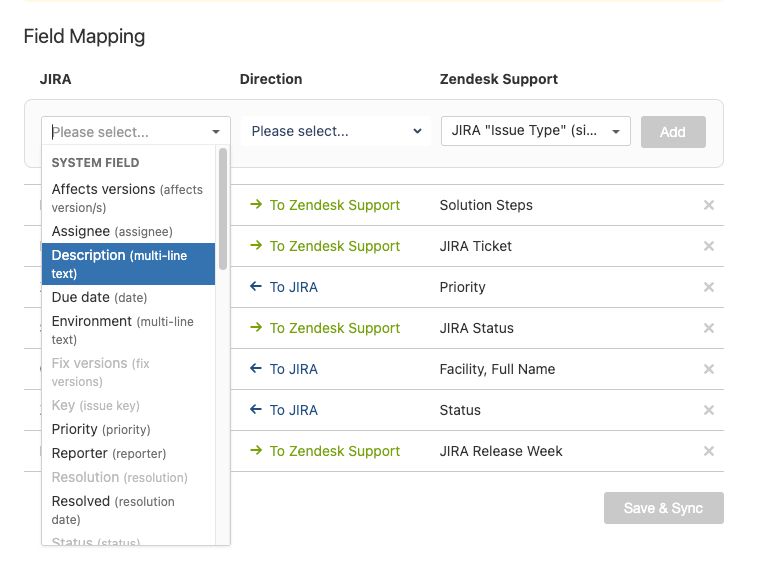

We have created a custom Field in ZENDESK called "ISSUE TYPE" so that we can use the existing field mapping within JIRA to push the issue type value to zendesk but we are having an issue finding that value in the first column as seen below.
Here is a screenshot of our Zendesk and the fields that we are trying to get to match.. the red below already works based on the settings above.. we are just trying for reporting and sorting visibity within zendesk to sync the ISSUE TYPE also.

Nic Brough -Adaptavist-
January 15, 2024
Issue type in Jira is a very structural thing - technically, everything hangs off the issue type (within a project - a bug in one project may not behave the same as a bug in another project, but issues in the same project have no choice but to work the same way.  And a lot of Jira people use the same config in their projects, so a lot of them look the same)
So you need to ask how they are doing it differently.
My "consultant" instinct is to also ask "why are you doing it differently?"
Sunny Ape
January 15, 2024
Same as Nick has said, when you integrate Zendesk to Jira, you specify what Issue type in Jira you want created when a Zendesk ticket is created.... and that's it. A single one-to-one relationship then exists between the two and there is no 'sub-relationship' or duplication of that relationship you need to map.
