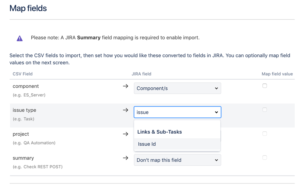

Apologies in advance, but after reading through the lengthy list of "fatal error + import" I have not found a solution to my fatal error.
I have a simple .csv that is 4 columns and 115 rows. On import, I'm only mapping "summary" and "component" to set up tasks for a project.
When I run the validator, it works.
When I run the import it fails, but all I get for a log is:

2018-11-06 23:31:07,096 ERROR - Fatal error during import:

My .csv header is
project,issue type,summary,component
The first row is
QA Automation,Task,Check REST POST,ES_Server
Unlike the other related posts on this topic, the log file appears incomplete, and I don't know why. I've tried logging out and back in. It didn't help.
I'm using Chrome 70.0.3538.77 (Official Build) (64-bit) and Atlassian Cloud.

You need to map the Issue Type field as well. That is required, as is summary.
Damian Romard
November 7, 2018
Thank-you Josh for the reply, but It isn't provided as a choice.
