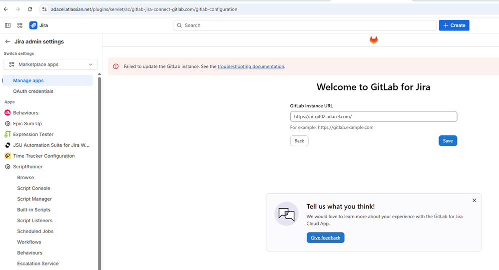

How to resolve this issue please?
Got it working now, I made some changes to the GitLab server, thanks.
nginx['custom_gitlab_server_config'] = "add_header 'Access-Control-Allow-Private-Network' 'true' always;"
Trudy,
I think that the issue is related to the CORS policy:
Access to XMLHttpRequest at 'https://xxx/-/jira_connect/oauth_application_id' from origin 'https://gitlab.com' has been blocked by CORS policy: Permission was denied for this request to access the `local` address space.

This link does not seem to resolve my issue: https://docs.gitlab.com/administration/settings/jira_cloud_app_troubleshooting/#error-failed-to-update-the-gitlab-instance
