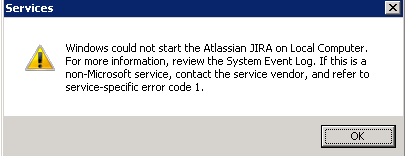

Hi Support,
I follow https://confluence.atlassian.com/adminjiraserver/running-jira-applications-as-a-windows-service-938847902.html steps to install JIRA in service mode under windows 2008 R2. I see there is a service Atlassian JIRA 8.3.1 installed

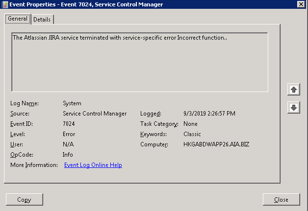

But when I start it, it cannot be started, from event log, it states
The Atlassian JIRA service terminated with service-specific error Incorrect function..
Event ID : 7024
Is there any log to show what it is happening ?

The most common issue with that error is that it cannot start java due to an update or something similar. I would start by checking the JAVA_HOME variable.
Alternatvely try to start Jira manually with the batch file, that should also display the information a bit better for you.
You can find the jira log files in JIRA home directory (on windows usually "C:\Program Files\Atlassian\Application Data\JIRA") /Logs/
For a good list on important directories and files : https://confluence.atlassian.com/adminjiraserver073/important-directories-and-files-861253886.html
